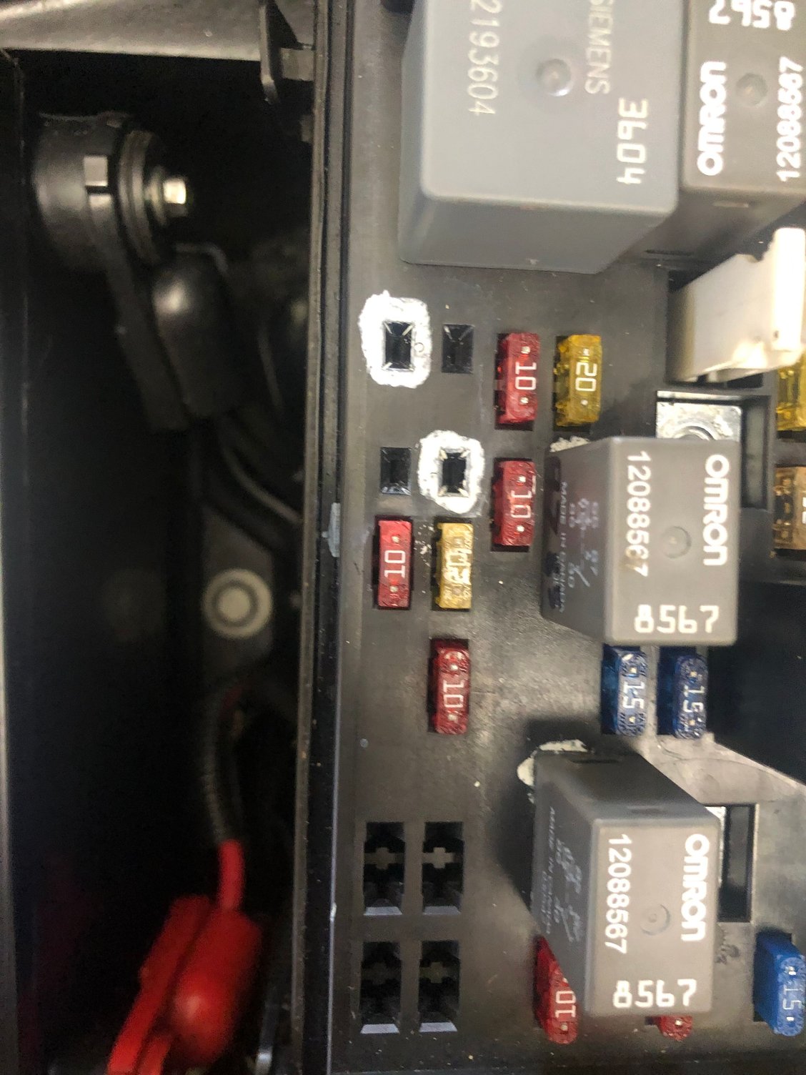

Posting for a friend. He just just purchased and drove home a 2003 that was only driven once this year. Kept clean and dry in a garage. 55K miles.
Next day started it and drove to gas station. While in line, he turned it off and restarted it TWICE when inching forward in line. The third time it wouldn't start. Pushed it to the pumps and filled the tank. Then when it still wouldn't start, pushed it off to the side. 15 minutes later, it started. Drove 2 miles home - but 3 blocks from home, going 25 mph, it stalled. Couldn't get it started. Called AAA to carry it home. My heart goes out to him since it's the newest Vette that he's ever owned and the weather was sunny today (in Seattle)!!!
Found 17 codes in Diagnostic. All marked "H".
BCM, RDCM, LDCM and SCM.
In researching what they are, I figured the BCM was most critical. (True?)
BCM Codes were B2578 and B2809.
One final data point. The wife said that when they tried to start it (after it stalled on the way home) that she heard a loud "whoosing" sound.
The battery is charged (VOM reads 12.6 V) and the starter turns over at normal speed. No gas smell in the garage.
CODES RETRIEVED (all were H, no C's):
BCM (Body Control Module)
B2578 RIGHT FRONT TURN SIGNAL MONITOR CIRCUIT Short to Voltage
B2809 <description not found>
RDCM (Right Door Control Module)
B2283 12V POWER FEED #1 FAULT Battery Fault
B2285 12V POWER FEED #2 FAULT Battery Fault
B2263 MIRROR HORIZONTAL POSITION SENSOR FAULT Horiz Position Sensor Fit
B2265 MIRROR VERTICAL POSITION SENSOR FAULT Horiz Position Sensor Fault
U1255 LOST COMMUNICATION WITH XXX Serial Data Line Malfunction
U1064 NORMAL SOFTWARE FUNCTION, HISTORY STATUS UPON IGNITION CYCLING Loss of Comms with BCM
U1016 NORMAL SOFTWARE FUNCTION, HISTORY STATUS UPON IGNITION CYCLING Loss of Comms with PCM
U1096 NORMAL SOFTWARE FUNCTION, HISTORY STATUS UPON IGNITION CYCLING Loss of Comms with IPC
LDCM (Left Door Control Module)
B2282 12V POWER FEED #1 FAULT Battery Fault
B2284 12V POWER FEED #2 FAULT Battery Fault
U1255 LOST COMMUNICATION WITH XXX Serial Data line Malfunction
SCM (Seat Control Module) (with AAB option)
B0851 BATTERY 1 OUT OF RANGE Battery out of Range
Any suggestions would be appreciated.

Does it turn over when he tries to start it?
Old Oct 6, 2021 | 11:42 PM
BillBarkerville's Avatar
BillBarkerville
Veteran: Coast Guard
Joined: Jul 2009
Posts: 153
Likes: 16
From: Issaquah Washington
Yes, it turns over normally at what sounds like the normal speed. Just no attempt at starting and no gas, or fume smell.

Old Oct 7, 2021 | 12:16 PM
BillBarkerville
Joined: Jul 2009
Posts: 153
Likes: 16
Thanks. We did clear all of the codes (after documenting them). But after numerous attempts to start the car, there are NO new codes showing up.
Reminder - the starter is working (turning engine normally) but there is no spark (fuel?) that allows it to start.
And, no new codes to evaluate.

When you put ignition ON the electrical fuelpump shall build up fuelpressure on the fuelrail for 2 sec . Do you hear the pump ?
If yes , you need a gauge connected to schraedervalve to very the pressure value .
Do you see any rpm when you crank ,if not the cranksensor may be the issue ?

As was mentioned listen if you can hear the fuel prime prime for 2 seconds when the ignition switch is turned on…if you hear it see if the Tach appears to move when you crank the engine over…this may point to a faulty crankshaft sensor..you will have no spark or injector pulse…you can pull a plug wire off the coil pack and see if the spark jumps to ground when cranking the engine…checking for injector pulse will require a 12 volt test light…if you don’t hear the fuel pump prime you can jump pins 87 and 30…see if the pump runs now. The 2 terminals to jump are in the below pic !!…if it doesn’t work swap the horn relay with the pump relay.

SUCCESS!!!
Just got it running! I'll post a full description later after I have lunch. (it's 5 pm and I've been B-u-s-y)

The Fix?
Old Oct 8, 2021 | 12:50 AM
BillBarkerville
Joined: Jul 2009
Posts: 153
Likes: 16
SUCCESS!!!!
The quick answer is that it was the FUEL PUMP RELAY (no. 35) that was bad.
The test that led to it was when I switched the FOG LAMP RELAY (no. 39) with the Fuel Pump Relay.
After that switch the Fog Lights wouldn't go on. And then...... the car successfully started!!
Called Chevy Dealer and they didn't have any relay available. They directed me to O'Reilly's Auto Parts.
They had a relay from two different companies for $25 and $19. We bought them both and put one in the glove box. :-)
It was a good day.
