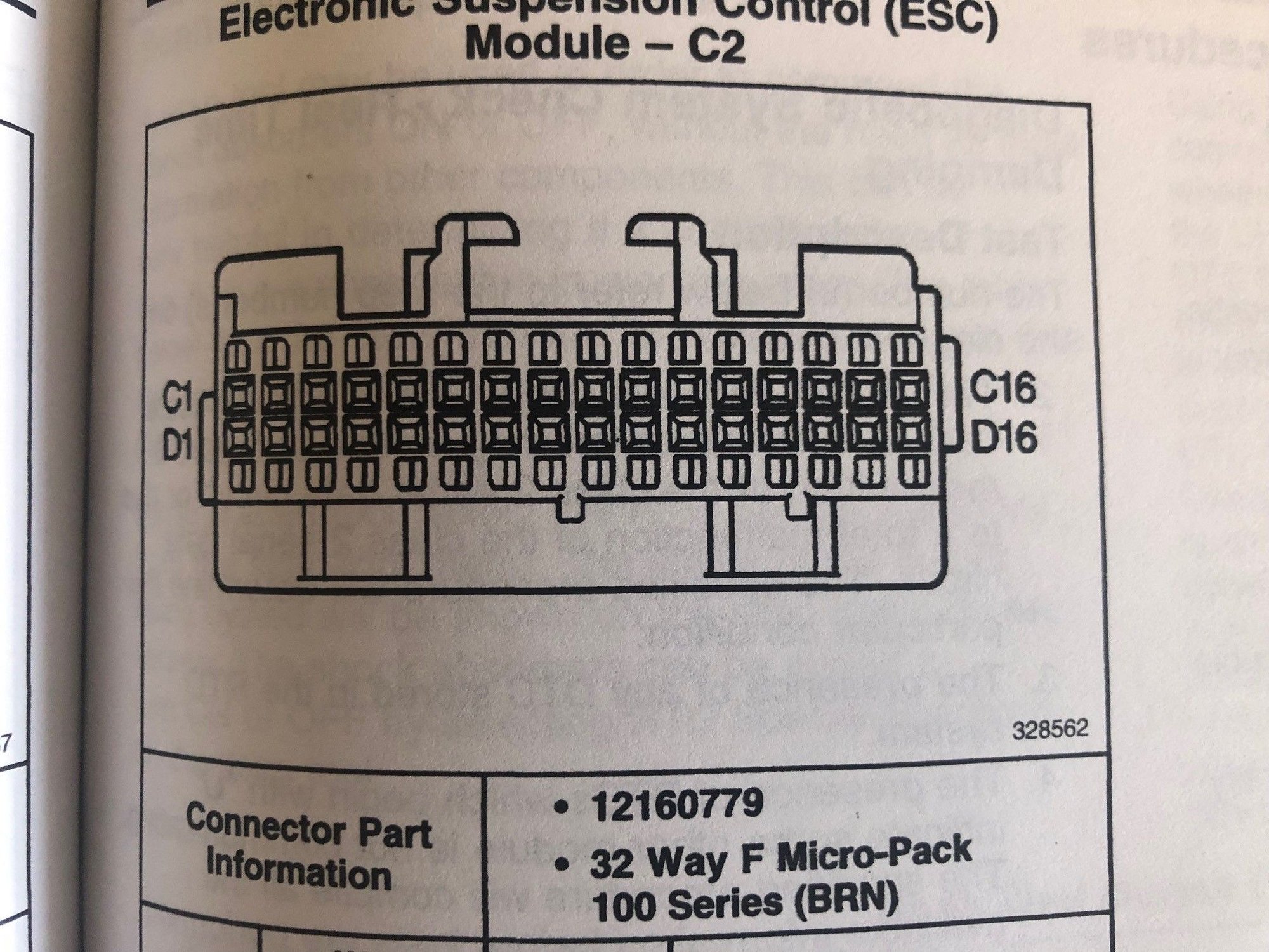

What do you mean by "everything seems to be in place" ??...a visual inspection only ??...you may have to go a little further...when the code says "open circuit" it's usually a wiring issue...I don't know if the PCM is looking at the power or ground circuit to throw that code...I see you were a "Thud" Crewchief so you should know your way around a voltmeter...The ESC (Electronic Suspension Control Module is located in that left little compartment in the trunk...with the key ON see if you have 12 volts at the light blue connector terminal wire...if not go right to the ESC and see if you have 12 volts at pin C12 on the C2 Connector which is a 32 pin connector (below) which is where it comes from...if you have 12 volts there but not at the shock you have a broken wire or bad connection...what grounds that circuit and makes the solenoid function is a PWM (pulse width modulated) ground from the ESC..I can't find anything about this DTC in the FSM, Mitchell or ALLDATA !!...I don't even have my ride control shocks anymore so I couldn't tell you if there is a certain resistance across the shock to be read.
I don't remember any of that in the 105 Tech Orders, so I'll have to take your word for it. This is a bit more complicated than the Thud. I'll get to it and let you know how i make out. I'm sure I could take a 105 in the 1/4 mile.
