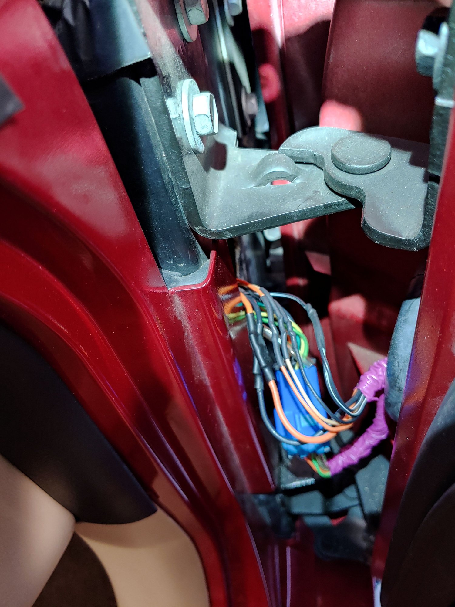

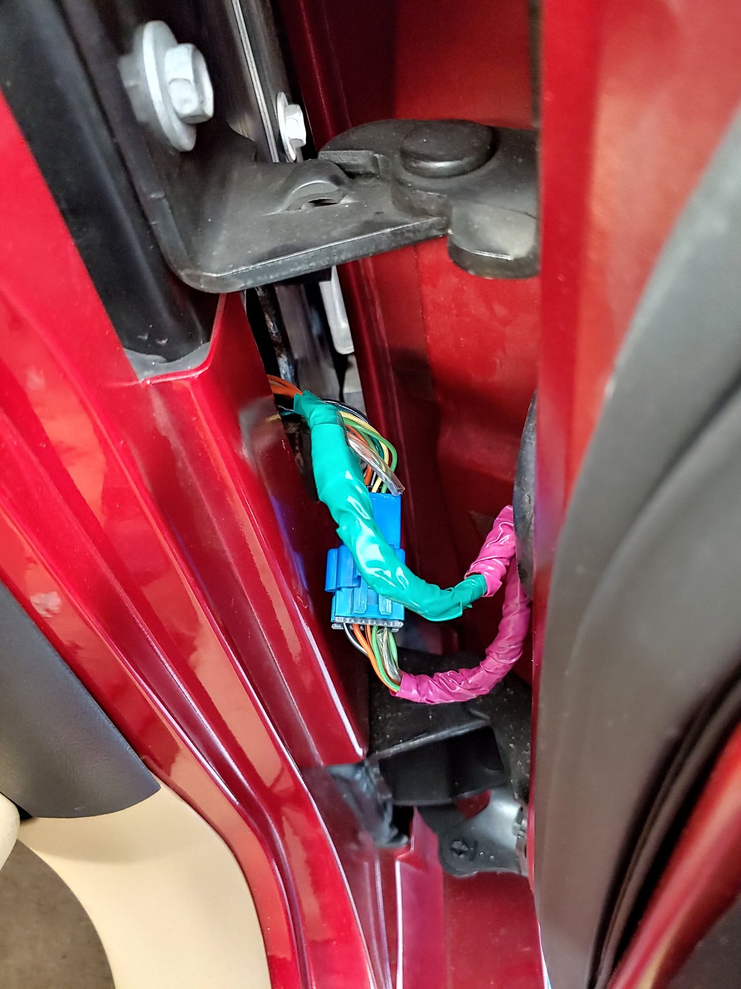

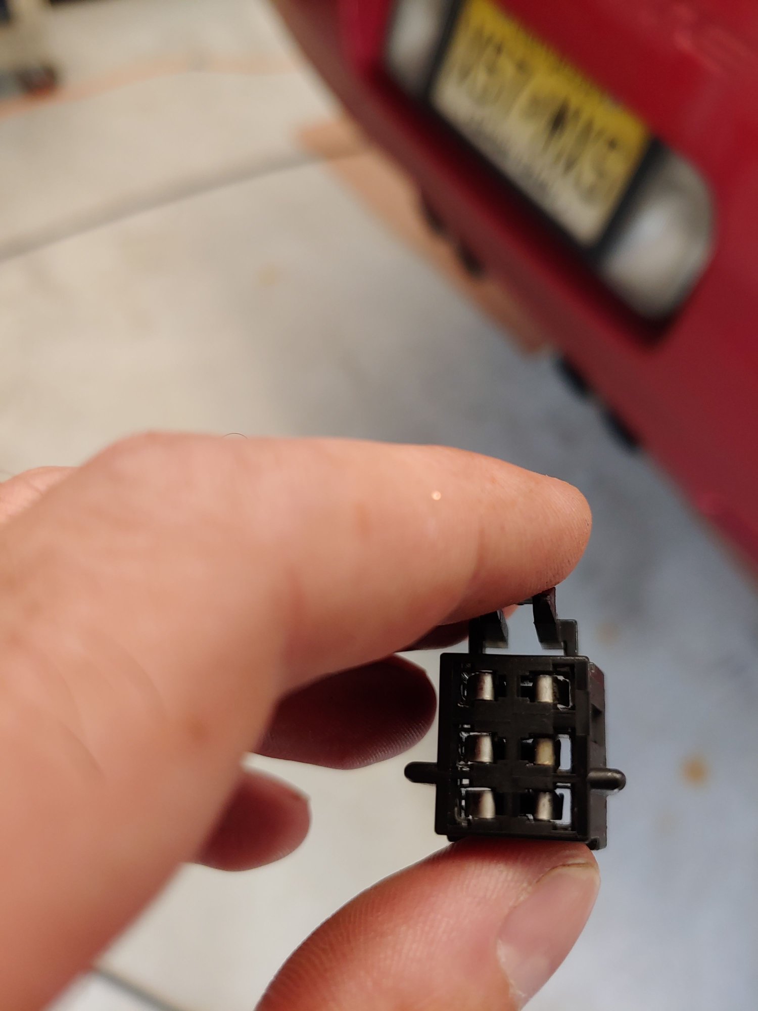

This guy. The blue connector was okay so I left it, but I deleted the black one. You can bend the pins back into shape if you want. Both sides were acting up on my car.
So, you cut out the black one and spliced the wires together?

I did soldier and heat shrink. It's a tight fit, you only have maybe 3" of wiring coming out of the car, but it's doable.

I would like to mention that I am confident that if I ever had to remove the door from the car I should be able to snake the wiring out of the door through the accordion hole, but I have not verified that it will fit through. Those connectors were for speed on the assembly line, so they could for build the door off the car in advance.
You can work the rubber accordion into the door to have room to work.

Most forum members who have had problems with that connector simply use a small flat blade screwdriver to bend the sockets on the connector so they make better contact.
