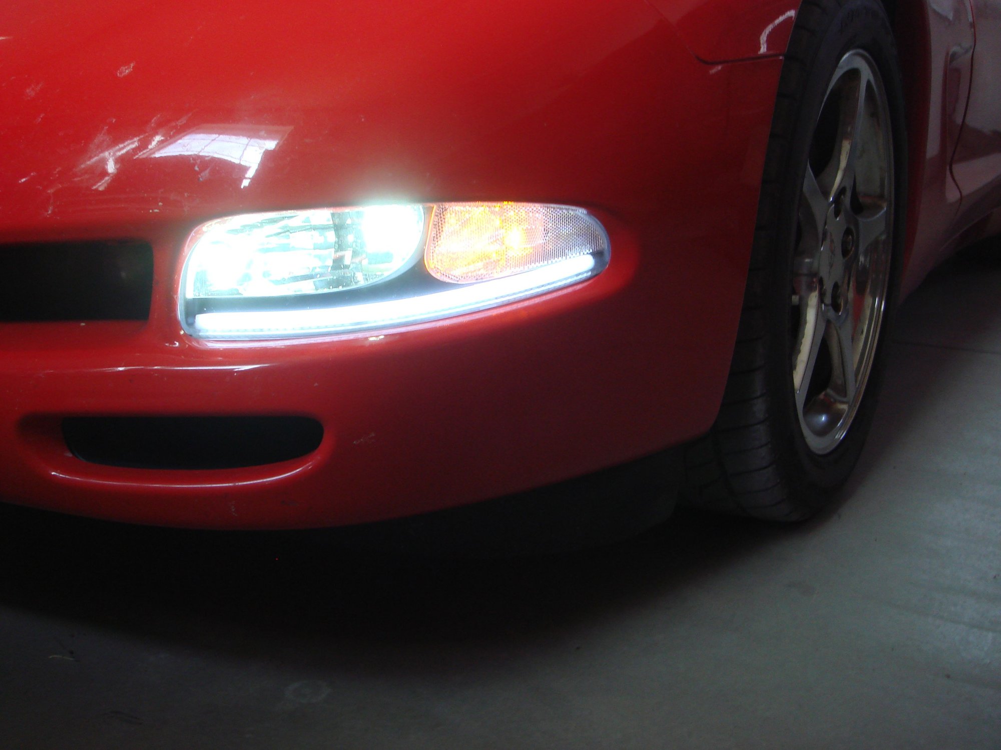

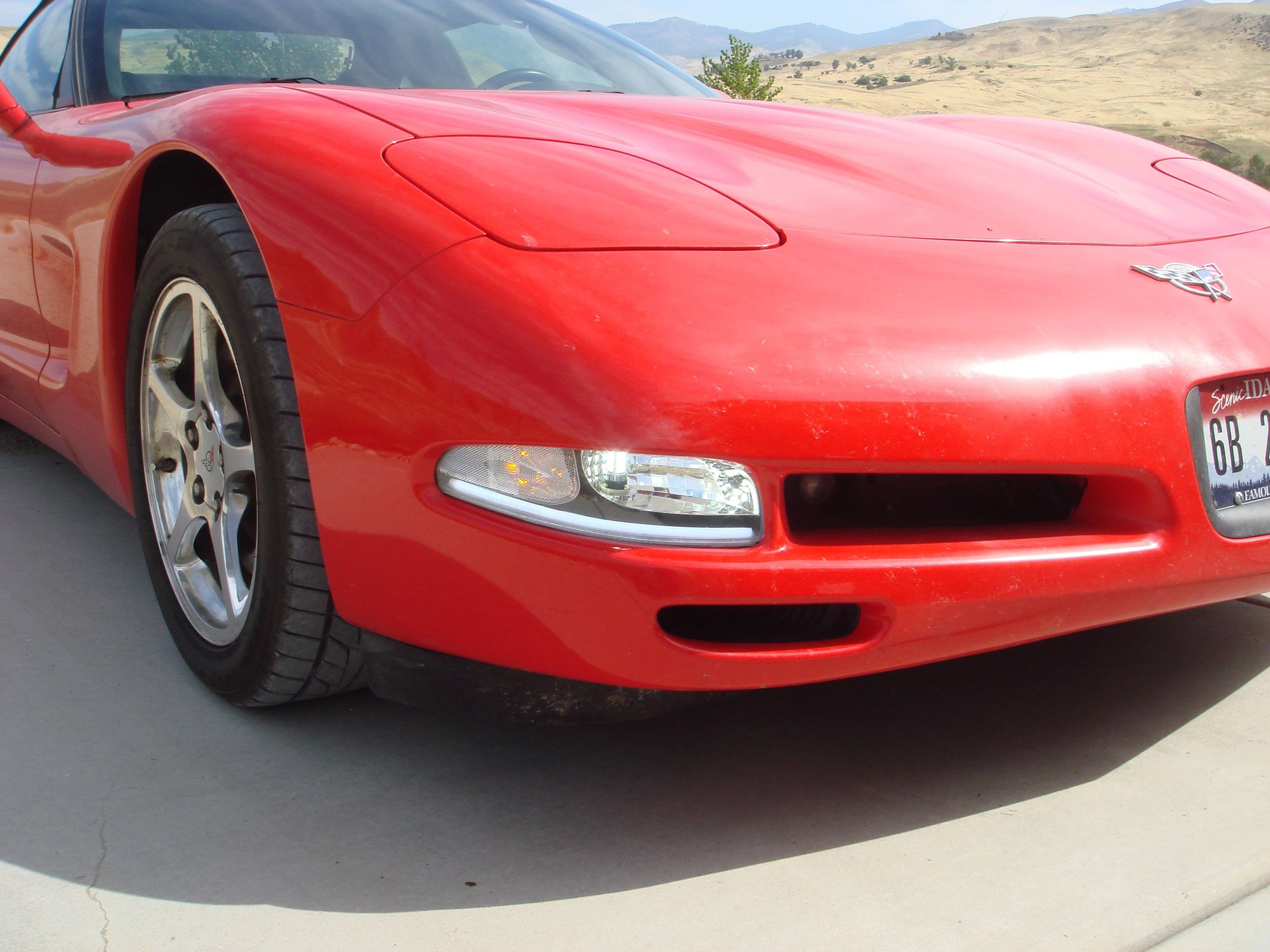

Okay, corrosion, and the plastic becoming brittle is a known problem. The easiest and cheapest fix for this is to buy new lens assemblies and replace them both. You can get OEM ones from Rock Auto pretty cheap. You might take the opportunity to upgrade to something with LED strips from Sharplight. (see image below) Removing the headlight assemblies to do this is not difficult. The first side will take you about 45 minutes, the second about ten. Good luck.
