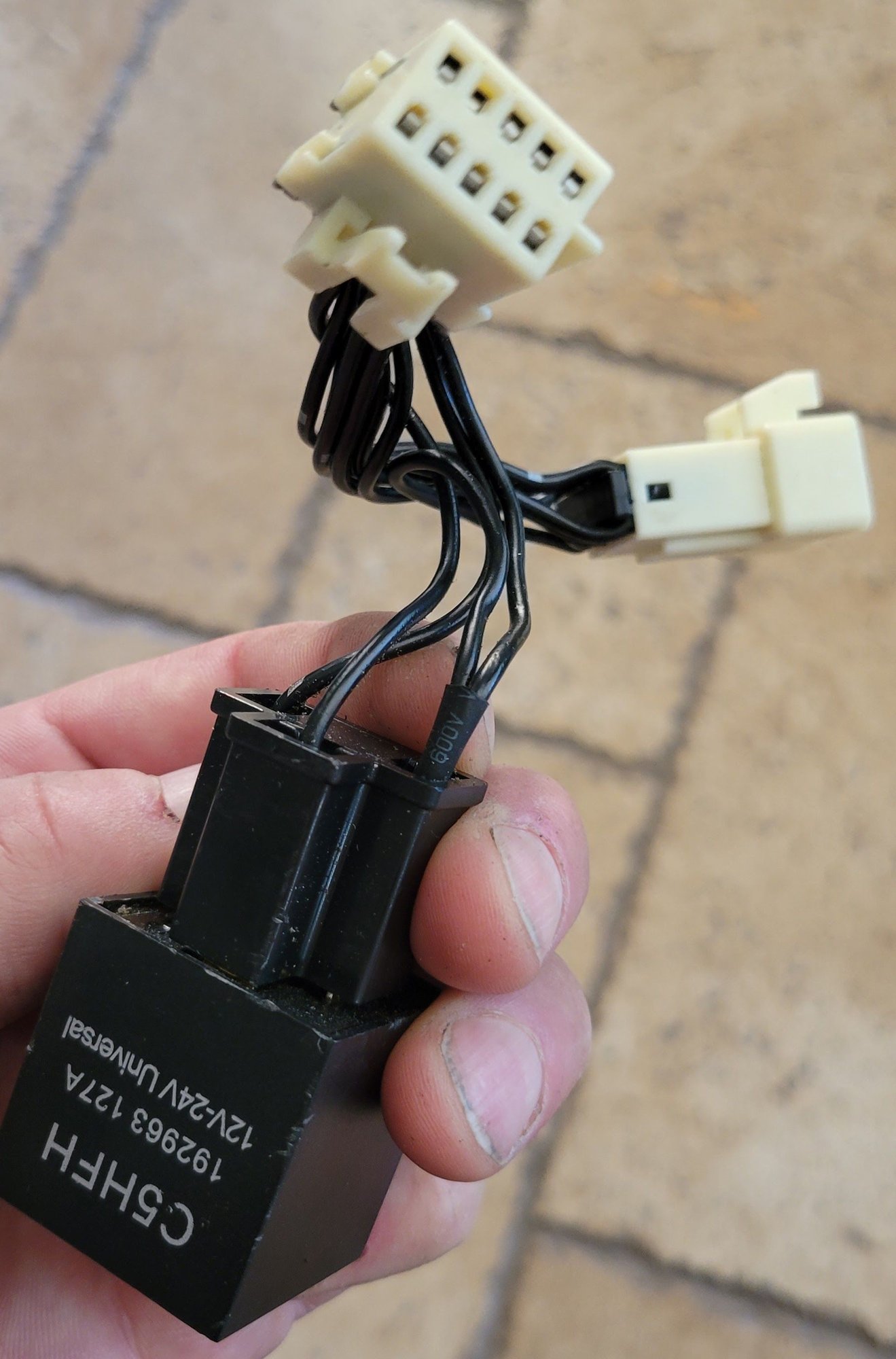

Did you recently add the LEDs and Hyperflash harness? If so I have seen one Hyperflash harness that was missing a wire which prevented the brake lights from working.
I don't remember which pin off the top of my head but all pins are used in the harness.
Had this issue with a hyperflash harness in a friends car.

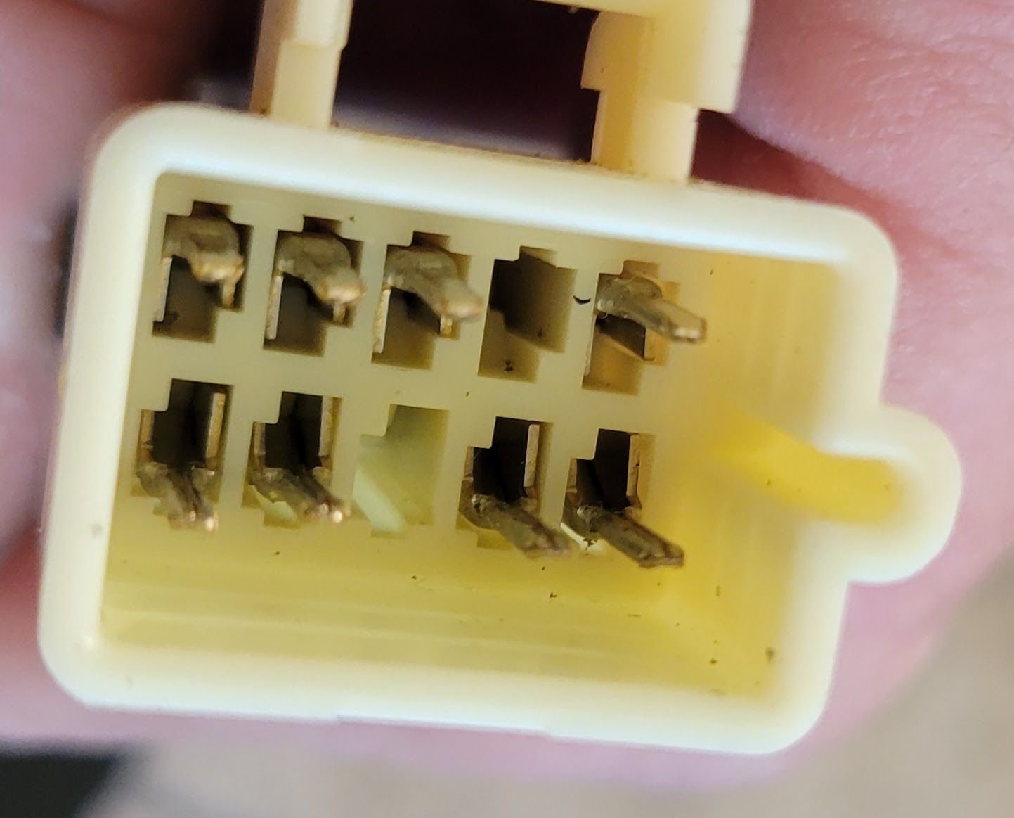

Hey Silver,
Male pins C and J are empty. All ten female slots are wired on the other end.

I decided to bypass the hyper flash harness, and the brake lights work fine. So the problem would appear to be with the harness. Is this a common problem? Should I try another one? I just bought the harness a couple weeks ago.

And I thought I was the only one to have this issue. Gary was the one who pinned my hyperflash harness for the brake issue. There were only 2 open slots on my harness, he pinned those. After that, the harness worked as it was supposed to. But I had bought my harness a looooong time before installing and thought the issue was just a bad batch or just my rotten luck, and by now the issue would be solved, apparently not. Since you just bought yours a couple of weeks ago, I would send it back and see if the new one comes correctly wired, Or maybe try another company's harness.
