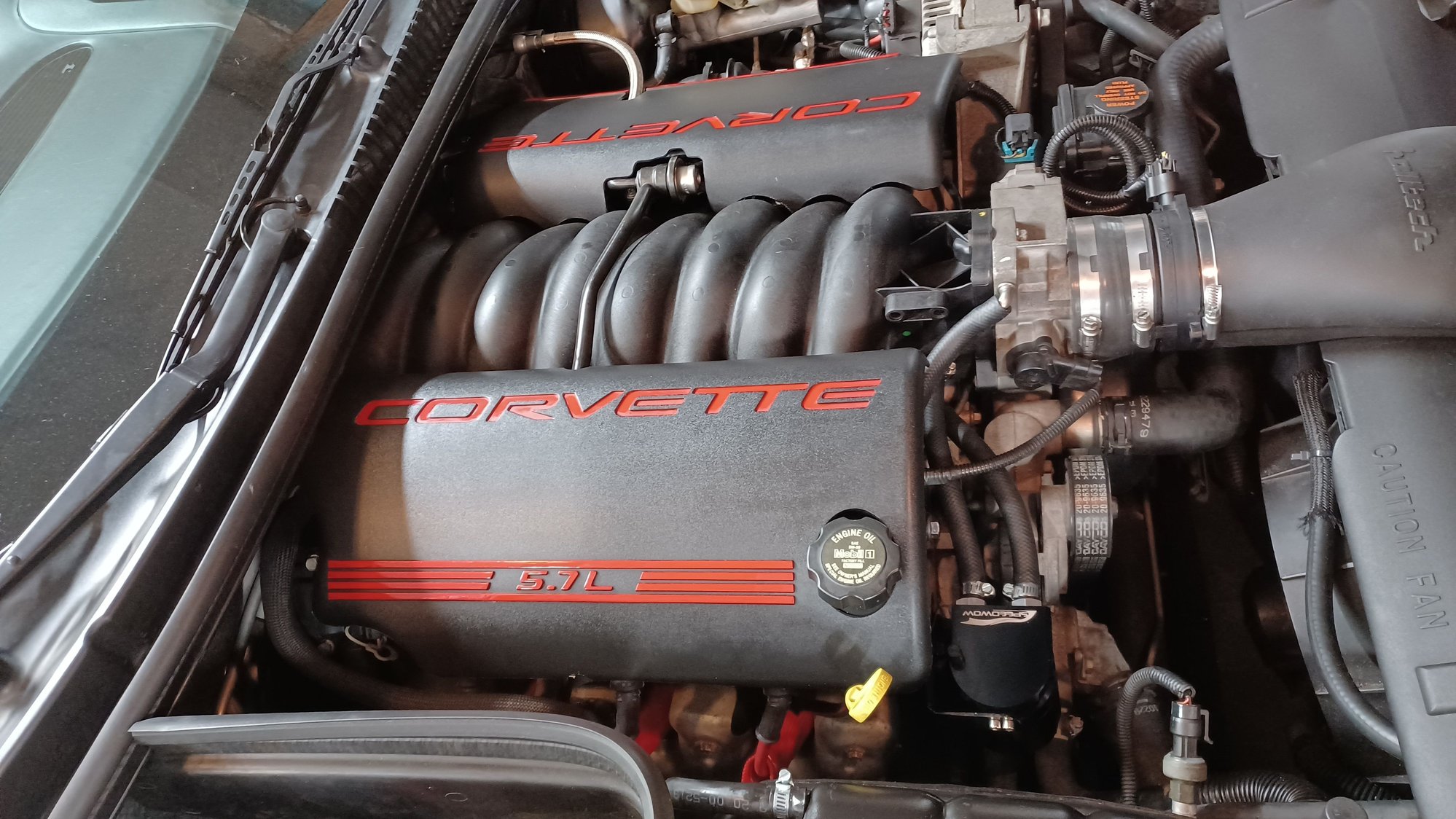

I am using an Elite Engineering E2 catch can. It came with everything you need to install it and cost me maybe 30 minutes to get it in. It has been effective. My exhaust is no longer coated in plastic, just soot.

I have the Mighty Mouse mild with billet bracket on my '03 Z. It works really well. There are people who say you don't need one on a stock motor, but when I drain mine, enough oil comes out that I think you do. The LS platform is well known for blow by.

I have a Mighty Mouse catch can and I really like it. It has a valve inside to replace the PCV and a blow off valve if pressure inside gets too high. It is also easy to drain. Works well on my track driven street car.
