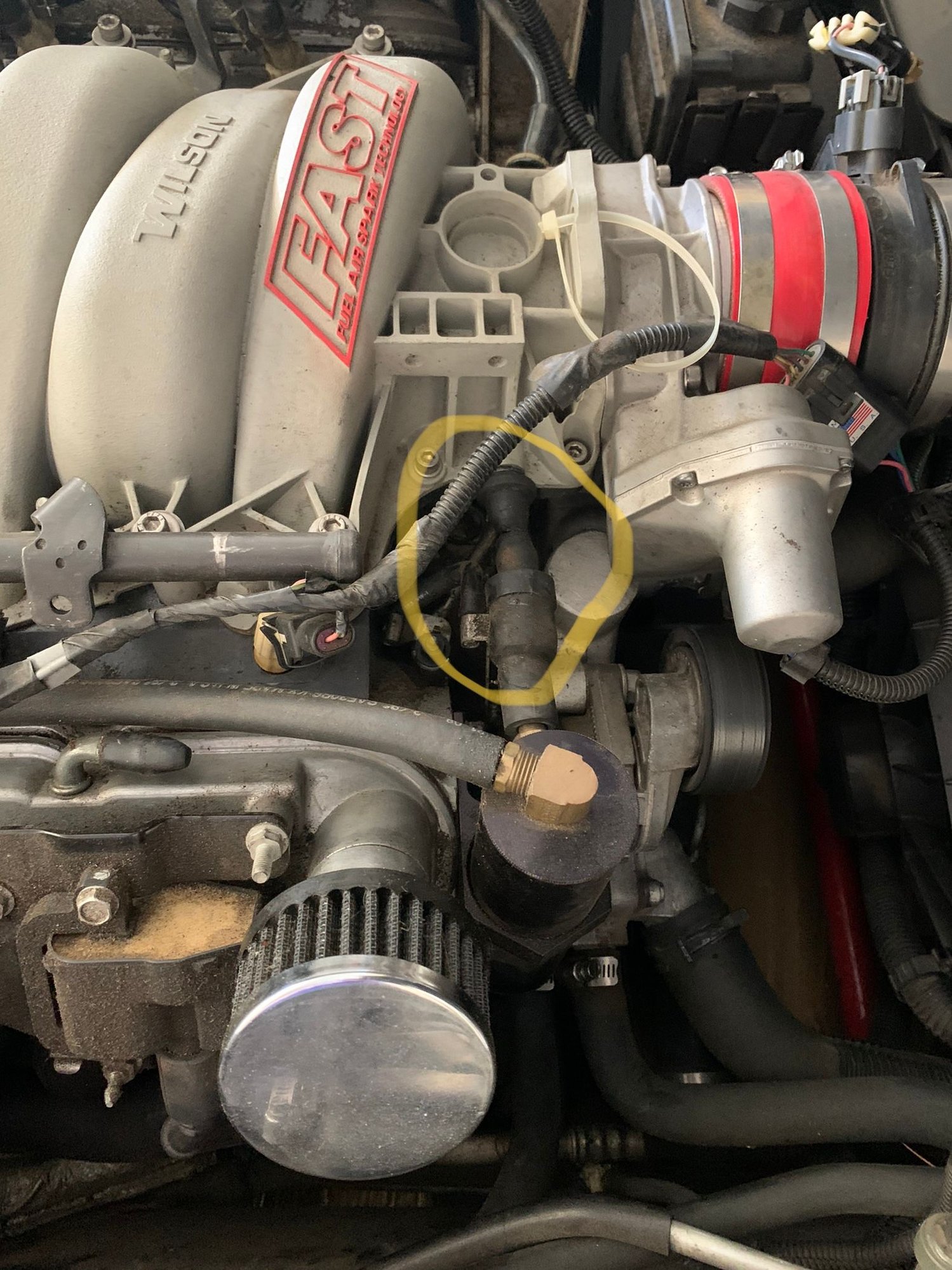

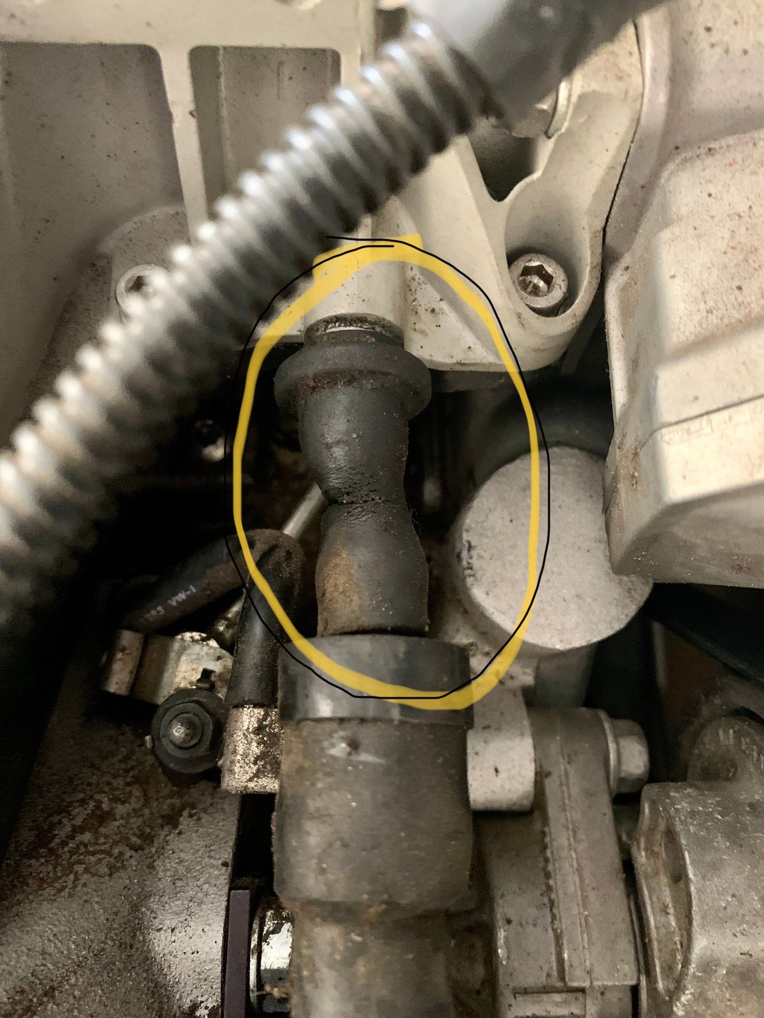

I just replaced my oil pressure sensor for the second time in my ownership and noticed the PVC hose on the passenger side that feeds into the intake manifold was torn. Started the car and everything amazingly seems fine except for that tear and resulting vacuum leak.
does anyone have the part number for that hose? It’s about 3 inches long and runs perpendicular on the car ( see pictures). Thanks!

You don't need a part number.
Just cut some 3/8" ID hose and replace your little torn piece with that.
