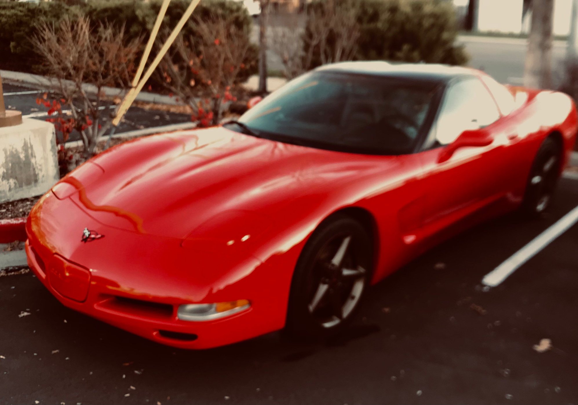

Originally Posted by C5VetteGuy!
Holy crap was this pic taken on a 2004 flip phone?
