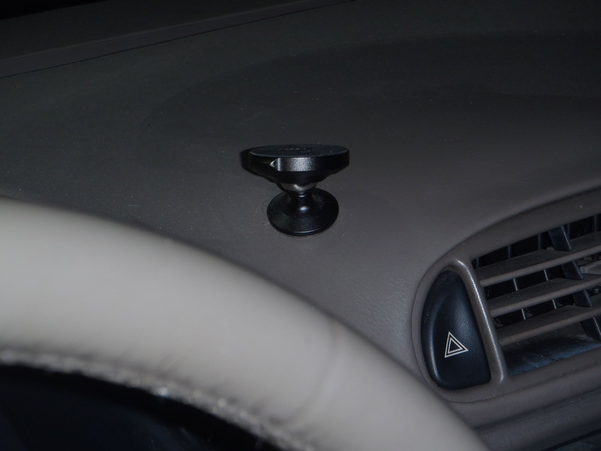

helphos what do you use to hold your phone?
I use a magnetic mount that sticks to the dash with 3M tape. You stick a steel disk to the back of your phone and the magnet sits on a ball and socket that holds it in place on the dash and can be rotated to give you the best positioning. I'm pretty happy with it. The mounts come with a couple of extra disks so you can use multiple phones. My wife has the same mount in her car so we are compatible.
Heres a picture. A little dark, but I hope it makes sense.
