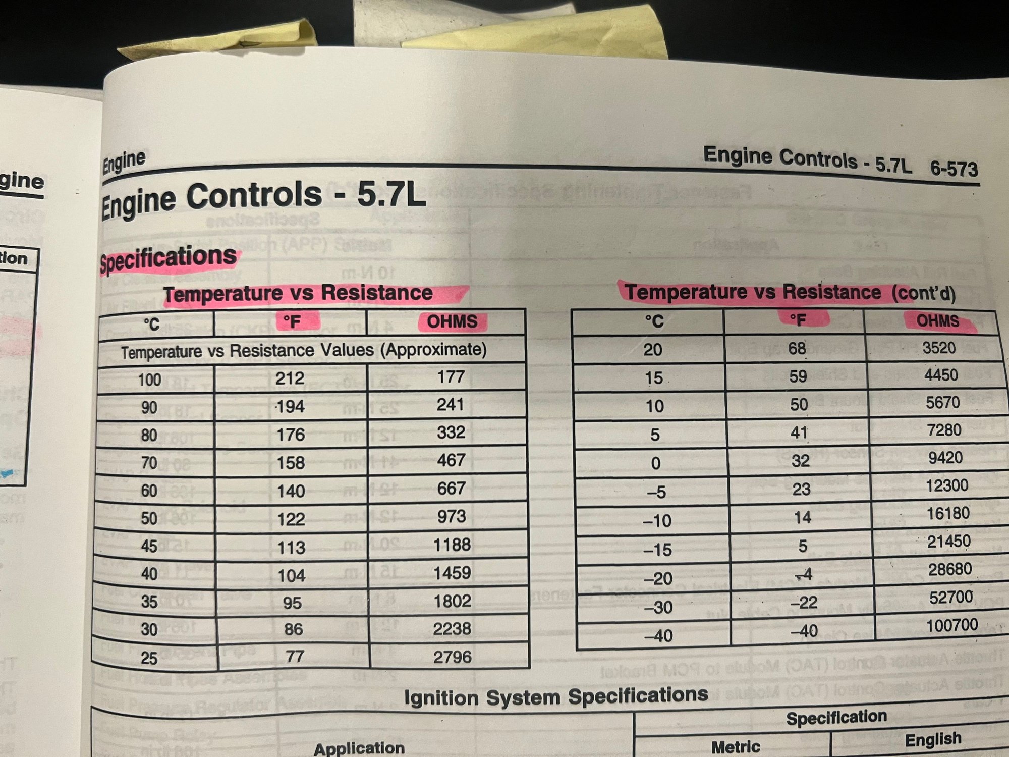

If the check engine light illuminated what DTC is stored ??…that may help in the diagnosis….what part of west Florida are you in ??…if you’re near Cape Coral/Fort Myers area bring the car by and I’ll look at it for you !!..also if you changed the thermostat you may need to “burp” the cooling system…procedure below.
1. Fill the system through the surge tank opening.
2. Fill half the capacity of the system with 100 percent DEX-COOL® coolant.
3. Slowly add clean drinkable water to the system until the level reaches to the base of the neck.
4. Start the engine.
5. Idle engine for 1 minute.
6. Install surge tank cap.
7. Cycle the RPM, idle to 3000 in 30 second intervals until engine coolant reaches 99°C (210°F).
9.Shut off the engine.
10. Refer to step 3 above to remove the surge tank cap.
11. Start the engine.
12. Idle engine for 1 minute and fill surge tank to 1/2 inch above COLD FULL mark on the radiator surge tank.
13. Install the surge tank cap.
14. Cycle the RPM, idle to 3000 in 30 second intervals until engine coolant reaches 99°C (210°F).
15. Shut off the engine.
16. Top off coolant as necessary, 1/2 inch above FULL COLD mark on the radiator surge tank.
17. Rinse away any excess coolant from the engine and the compartment.
18. Inspect the concentration of the coolant.

None of those DTC’s will illuminate the MIL but something like an ECT sensor will…the coolant temp must exceed 282 degrees for 20 seconds for the MIL to illuminate…the MIL will extinguish if the car is started 3 times and the PCM did not see a fault…is the MIL on right now ??…there is not really a “diagnostic process” you would use like for other driveability issues but other than checking for blockage of the radiator/condenser, burp the system, check the radiator cap and maybe look at replacing the water pump…you really don’t know if the ECT sensor is accurate but you could do a resistance check after the car sits over night…the coolant temp should be close to the outside air temp…see what the DIC shows for a coolant temp and check the temp in relation to the resistance chart…did you try running the heater and blower all the way up and see if the temperature decreases somewhat ??…there are no modules that will generate cooling codes…the SDM is the Sensing and Diagnostic Module which is the airbag module.
