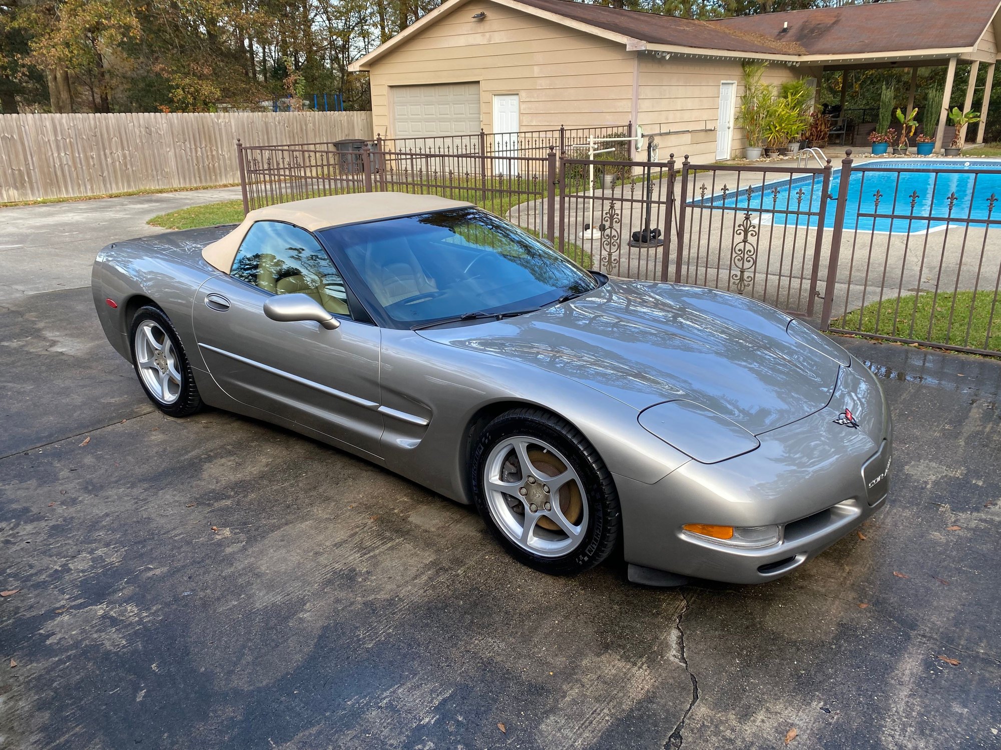

Greetings everyone. I am a new Vette owner, recently purchasing a 2000 convertible from an elderly gentleman who only put 11k miles on her in 22 years of ownership. Louisiana summers are extremely hot when storing a car for years on end, and I’m concerned that this beautiful car has been very neglected. I’m coming across several issues already and I’ve only had the car a few weeks. The ultimate issue is I had to have the car hauled back to my garage after what appears to be a failing Harmonic Balancer that I’ve read so much about.
My concern is, while I’ve read alot about HB wobble and eventual separation of the rubber component, mine went into a very nasty “shudder” at highway speed, CEL came on, and the engine quit on me while coasting into a parking lot. It really sounded like it threw a rod or something significant internally. I can’t tell if I have the “death wobble” and I don’t want to run the car at all until my local performance shop can get their hands on it. Oil pressure was good for a very brief restart.
Can anyone here relate to this issue before I start throwing money at it?
