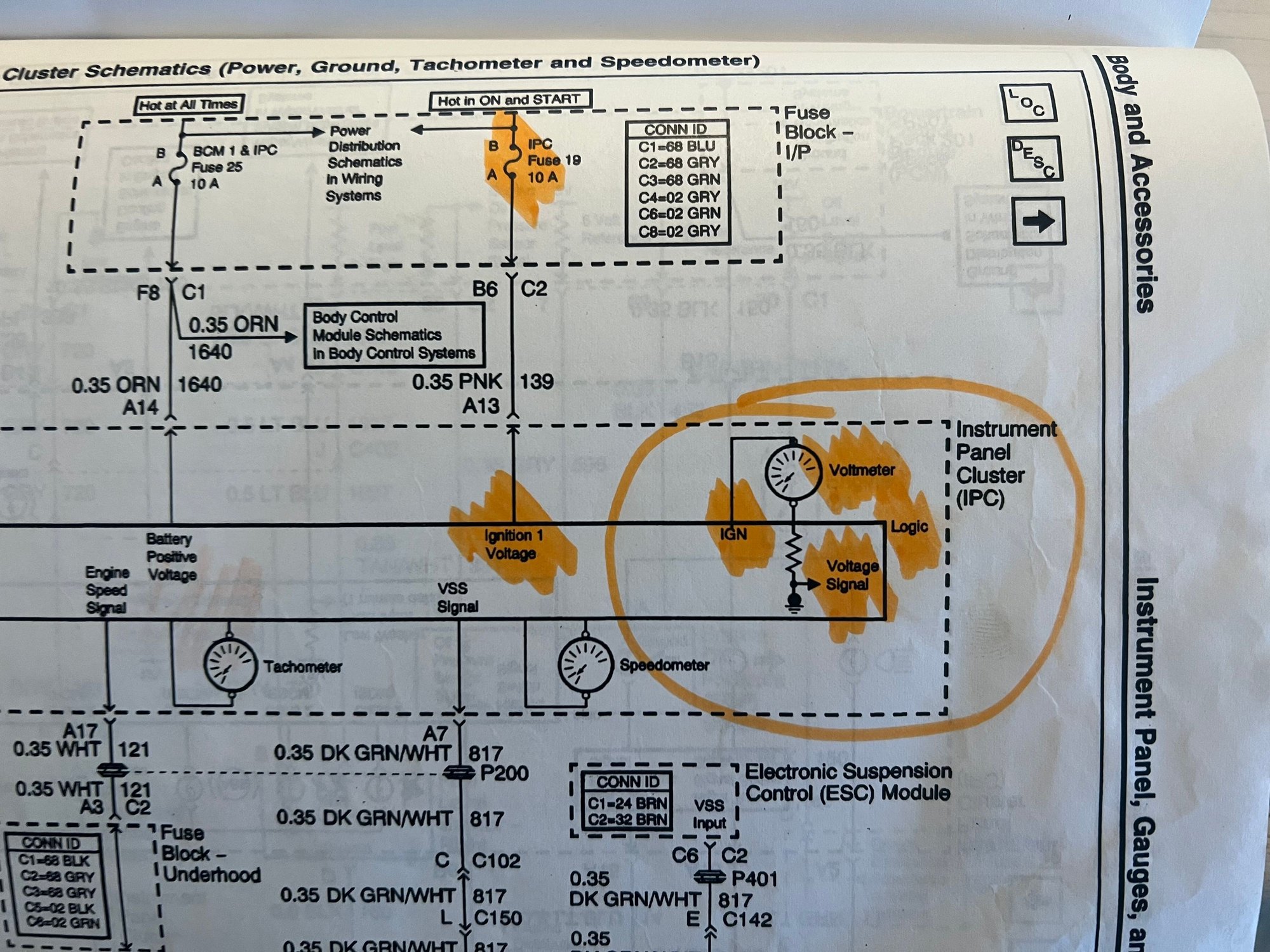

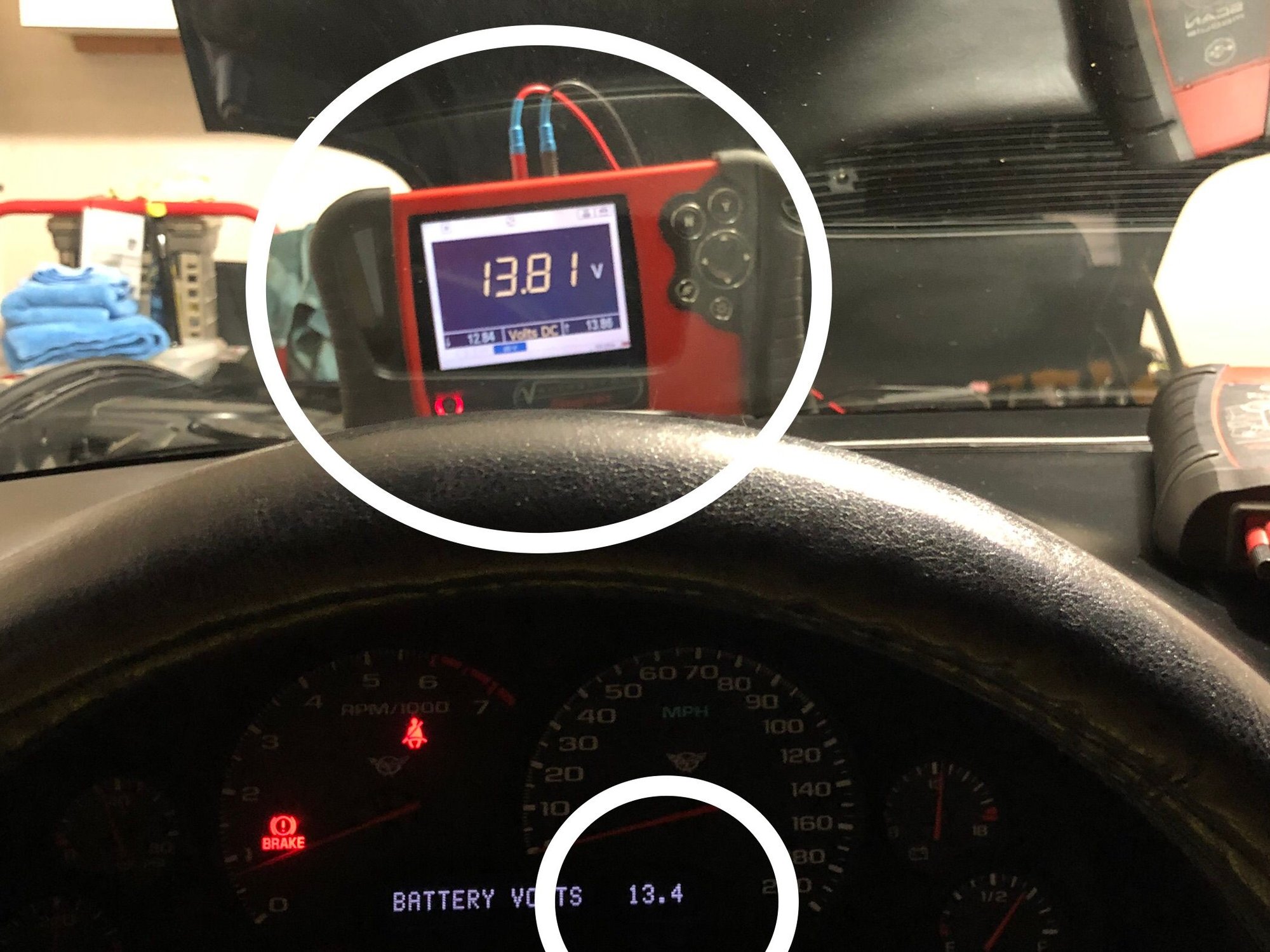

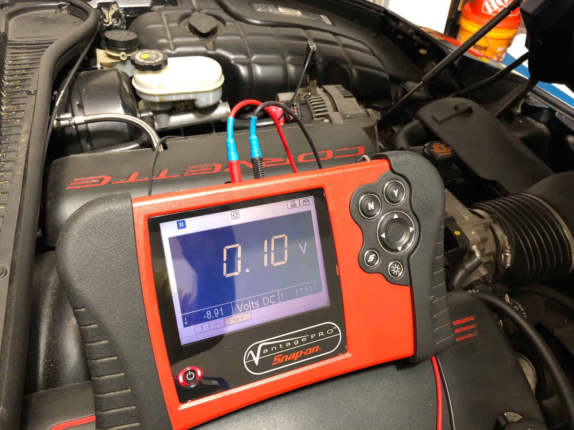

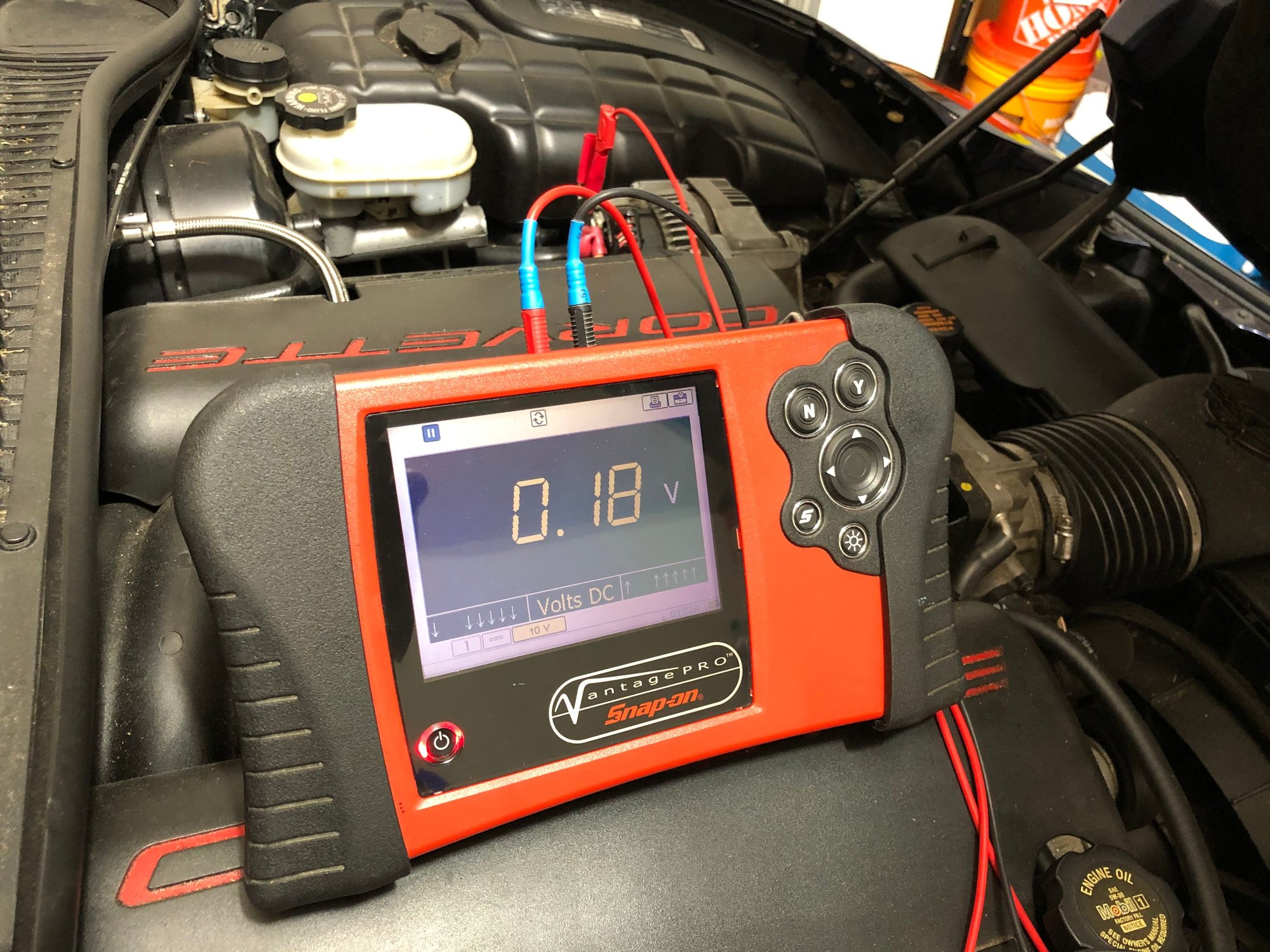

First question is where are you reading these voltages…on the DIC or with a DVOM across the battery terminals ??…as you can see in the picture the DIC voltage is around .4 volts lower than at the battery itself…so with a load…AC, blower, headlights on what does it drop to…14.1 ??…what voltage at the battery if lower than that ??…14.1 is fine…it is a always a good idea to to a voltage drop test on the positive and negative side of the charging system…with DVOM place the meter leads from battery positive to the B+ of the alternator and on the negative side from battery negative to the alternator case….this is done with the charging system under load and at around 2500 RPM or so….you should see around .1 to .2 volts as you can see in the other 2 pictures on my car…GM’s values are .5 volts.
Negative side voltage drop
Positive side voltage drop

Batteries life is less in you live in warm climates like
Georgia and worse yet for me here in Southwest Florida…as you can see below the voltmeter comes from the IPC module from fuse 19 through the fusebox and if you follow that upstream it goes through the ignition switch so you can see why there is a .4 volt drop in voltage…it can also be some oxidation starting to show up on the ignition which our Corvettes and other GM platforms have issues with…I would still do that charging system voltage drop check to make sure the wiring is up to snuff
