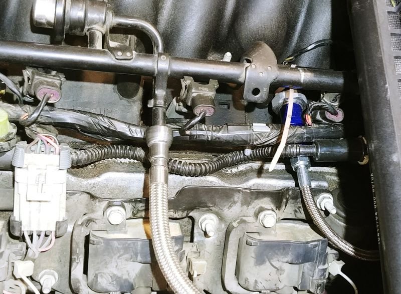

Originally Posted by Kubs
I have my intake off now for another reason, so now would be a good time to do the relocation of the sensor. Where are you guys putting your relocated sensor? Zip tie to the fuel rail or some other location?
In my case, it's zip tied to the fuel rail. In the pic below the sensor attaches to the blue fitting. The wire harness reaches this spot nicely. And the best part is that it's hidden by the beauty cover aside from a little tail of the SS braided line coming out near the firewall.
