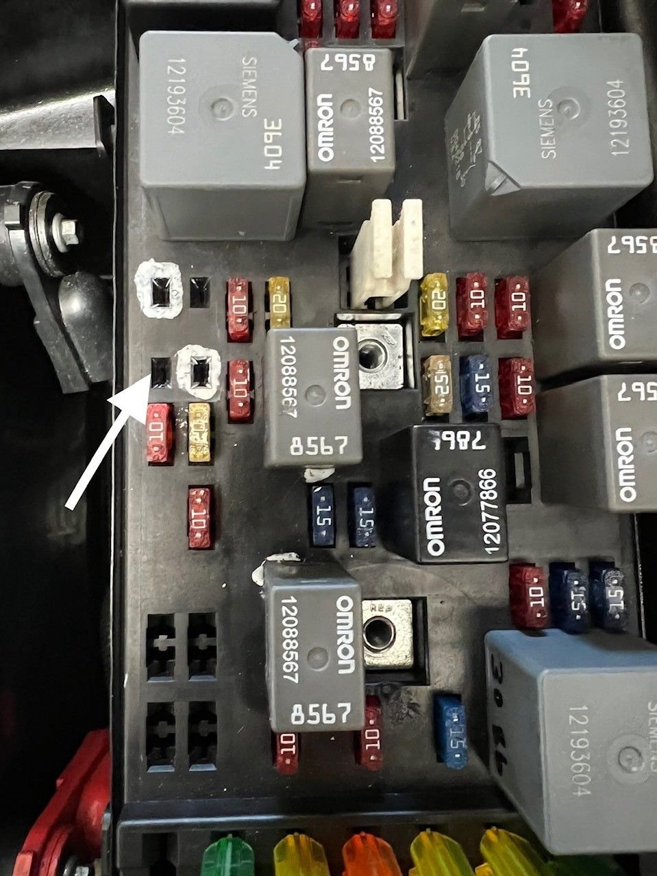

The ECT uses a 5 volt reference and you will see that on the yellow wire with the key on and sensor unplugged...see if you have 5 volts there...normally if you unplug the ECT sensor the coolant temp will read around -38 degrees...also unplug the MAF sensor and see if you have 5 volts on the yellow wire there too with the key on...just curious...as far as the fuel pump not priming remove the pump relay and with a 12 volt test light connected to ground see if the test light comes on for 2 seconds when you turn the key on probing the terminal below…you may have a few different issues here !!…the cooling fan is most likely running because of the ECT sensor…if the 5 volts is shorted to ground the PCM thinks the engine is overheating…the ECT is a thermistor circuit and having the 5 volts shorted to ground will not damage the engine computer…trying to figure why it goes off when the key is inserted…you should also see what codes you have stored if you can.
