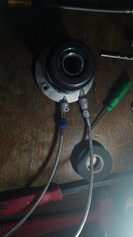

Thanks to everyone for the feedback, especially the idea to call TICK Performance. They sold me the correct part today, Earl's Steel Adapter, T56 Clutch Slave to -4 Male AN fitting. Part # is LS641001ERL. Hope this helps the next poor soul working on his clutch job. I love this Forum! Irish

McLeod 139026 Quick-Disconnect Fitting Straight -4 AN Steel Zinc
I still run tick master, I used that fitting to convert to all AN lines, from the master to the slave, get rid of the oem push connect thing, and route the clutch line away from heat, though I don't remember what fitting is on the oem master side of things. not sure if this helps. I dont want to get rid of my tick master though, so I'm just to run a clutch stop, to avoid over extension of the pressure plate, granted i've technically been "overextending" it for 5 yrs of the 8yrs i've had my twin disk McLeod.

with my turbo kit, it was right in the mix. so I replaced it was a longer braided 4AN line, away from the exhaust stuff.
even N/A they run close to the headers, boiling the fluids during back to back pulls, making the pedal spongy.

yes, I have an accessible male to male AN coupler in the middle. so i can disconnect the slave if needed.
