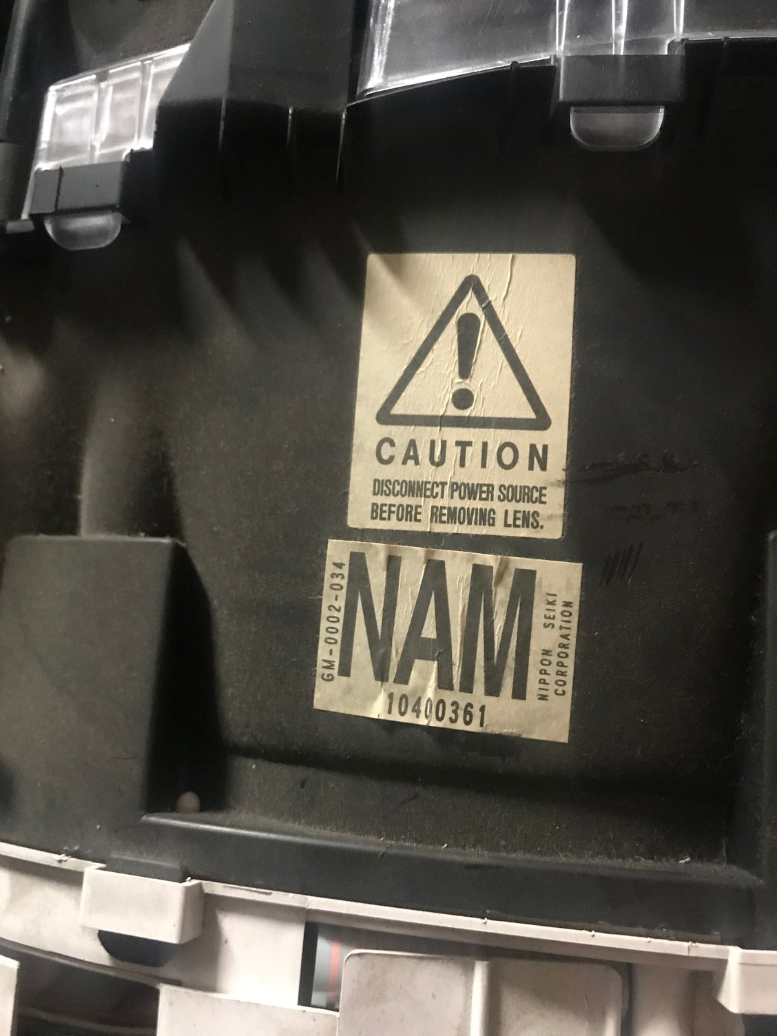

My speedometer started sticking, so I’m planning to replace my instrument cluster. Looking on eBay, I noticed some of the clusters have different letters on the white sticker: NAH, NAX, NAM… Does it matter if these letters match?

Unknown.
But I thought I'd offer a half thought. I say that because I don't remember the product, but recall seeing an obd2 connector which would reprogram mileage. Not sure if it works. And you're probably still better off going through the dealer for potential legal purposes. But they're out there supposedly.

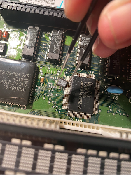

Fyi the car has two chips which record mileage. One on the cluster, one somewhere else. I believe it is something like chip U12 on the cluster?

Thanks for the reply. Yeah, I think you’re right about taking it to the dealership. I’m sure they’ll know the process for updating it.

Just install the circuit board from yours into the new one and the mileage will be correct.Takes about 5 minutes.

This clustercard with the odometer chip or only the chip that is needed to be moved to the new cluster to be able keep the correct milage

Hahaha, how close was I pulling that memory from 2013? I guess U12 and it is the U13. Good enough to be CEO of GM!
