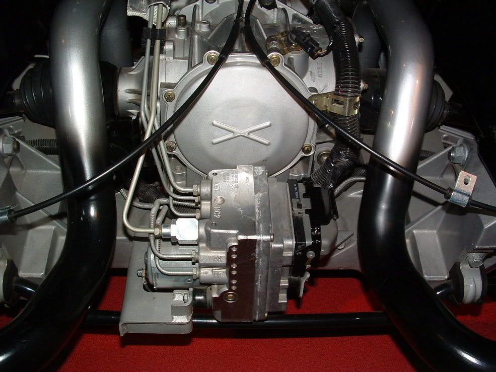

Hi all,
I'm trying to replace a brake line that runs from the master to ABS that is mounted in the rear behind the diff. The top brake line connection in the back (closest to the X on the diff in the pic) is the line I"m replacing. Does anyone know where that line connects on the master? I'm having a hard time tracing it and I don't want to guess which connection it is at the master. Thanks

It's engraved right on the abs unit, you can see R.R. L.R on the 2 you can see in your pic.

Wow, how did I miss that. Ok, so the port/connection I'm replacing is MC1 (master cylinder 1); however, when I look at the MC I do not find the same markings. Where is MC1 on the MC? much thanks!

isn't one line bigger than the either? the bigger one I assume is 1
