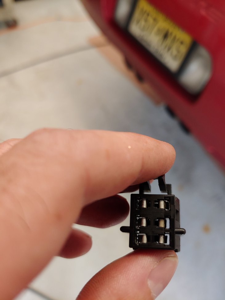

It's a fairly common problem for the electrical connectors in the door jams to have spread terminals. My car had a similar issue and this is what I found.
Try wiggling the rubber accordion between the door jam and the door.
