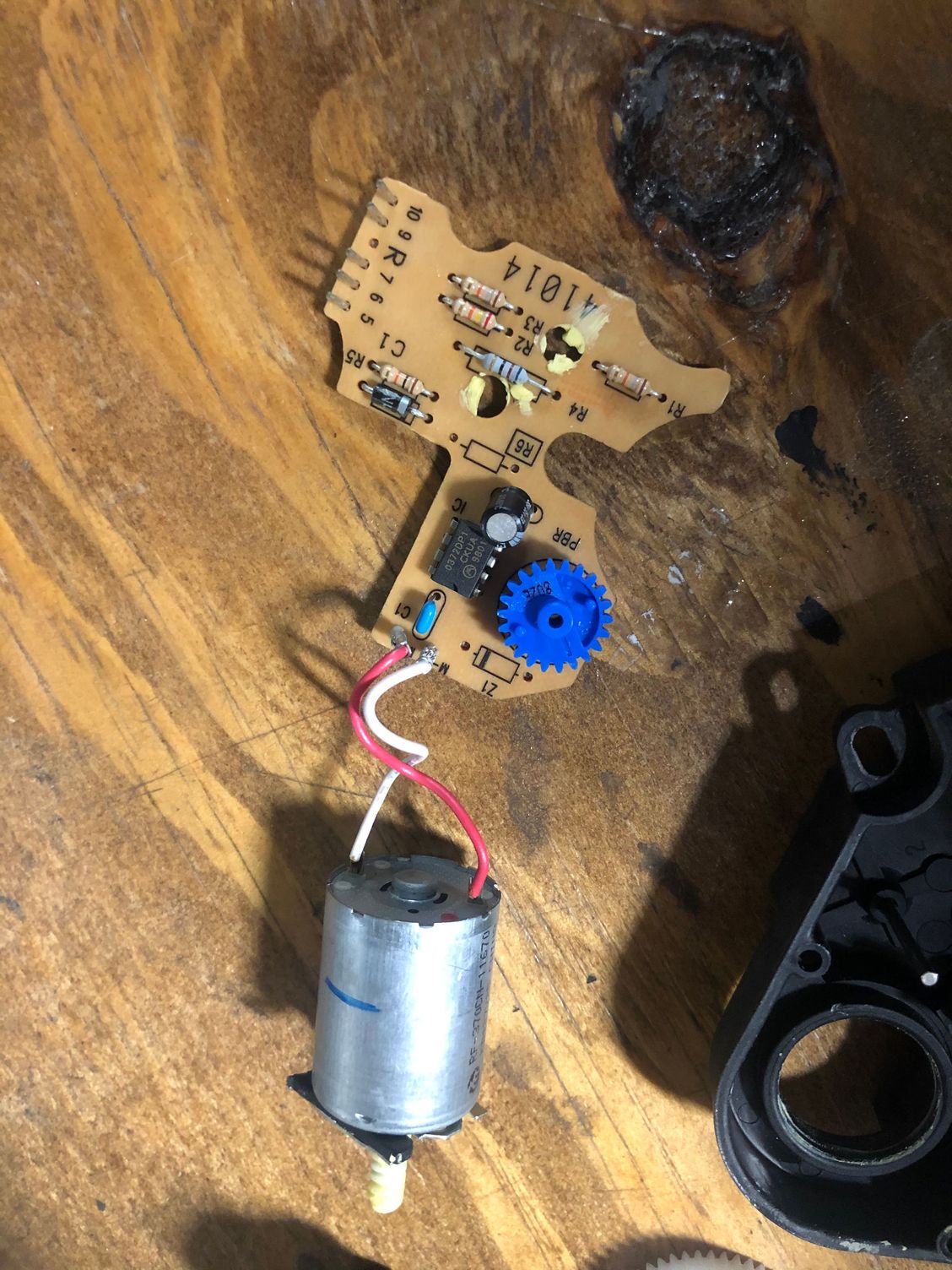

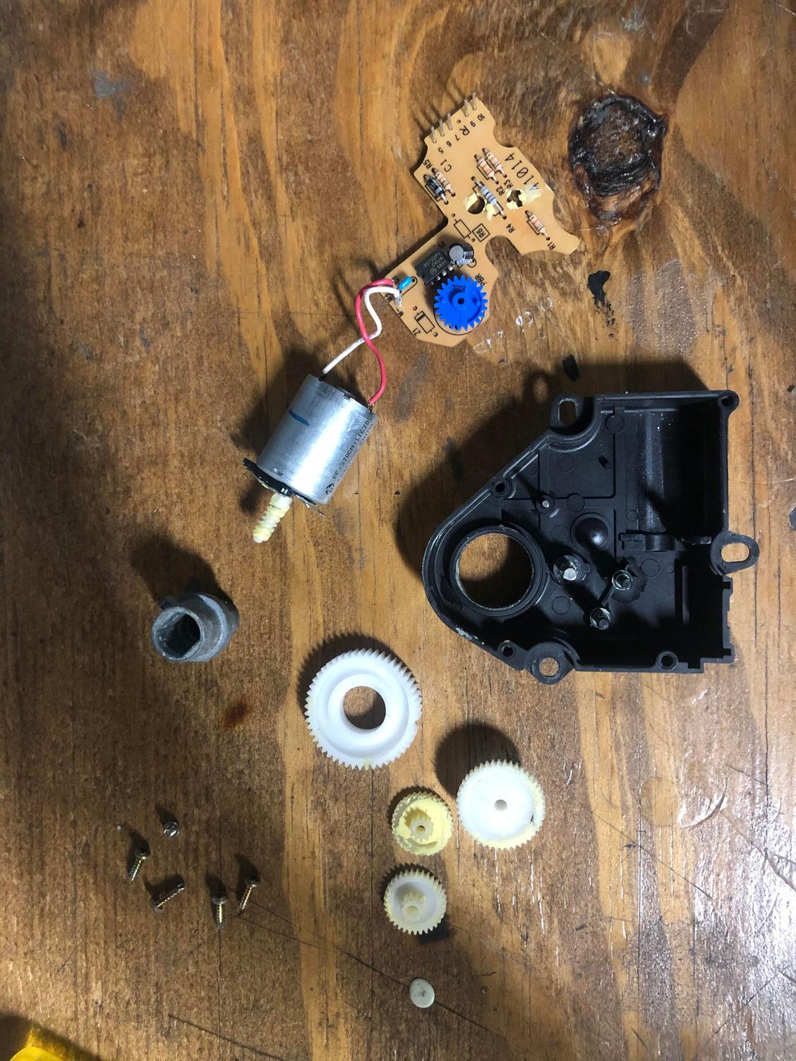

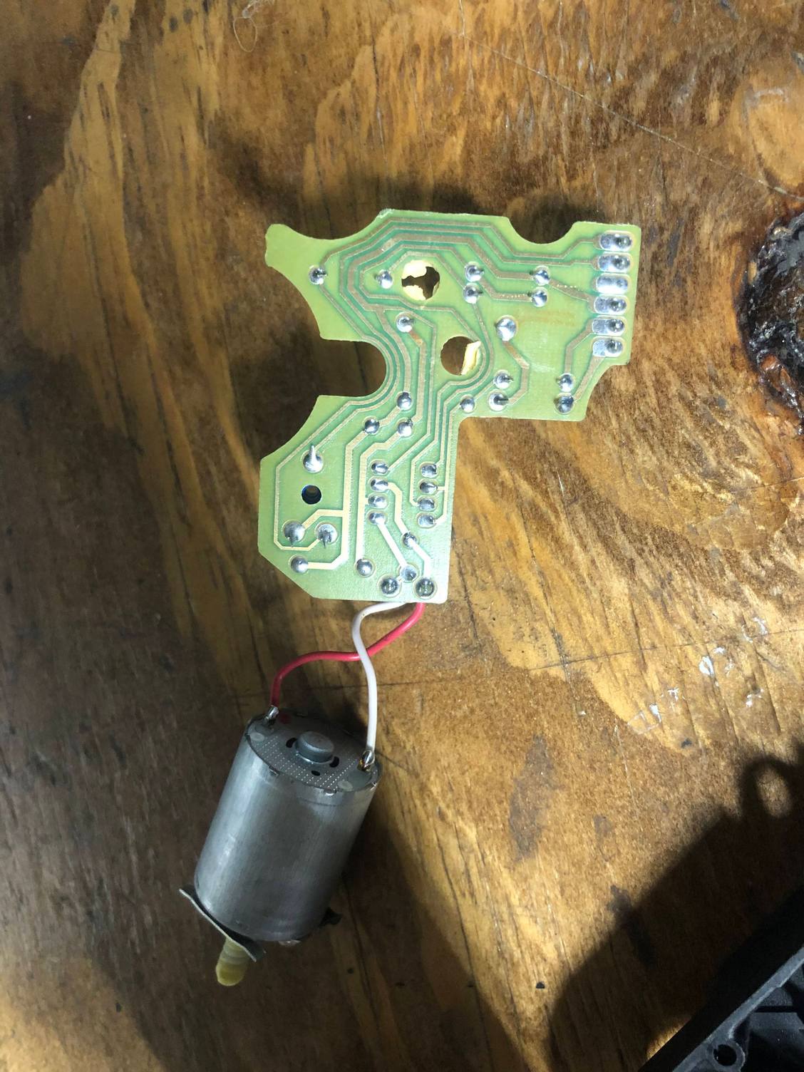

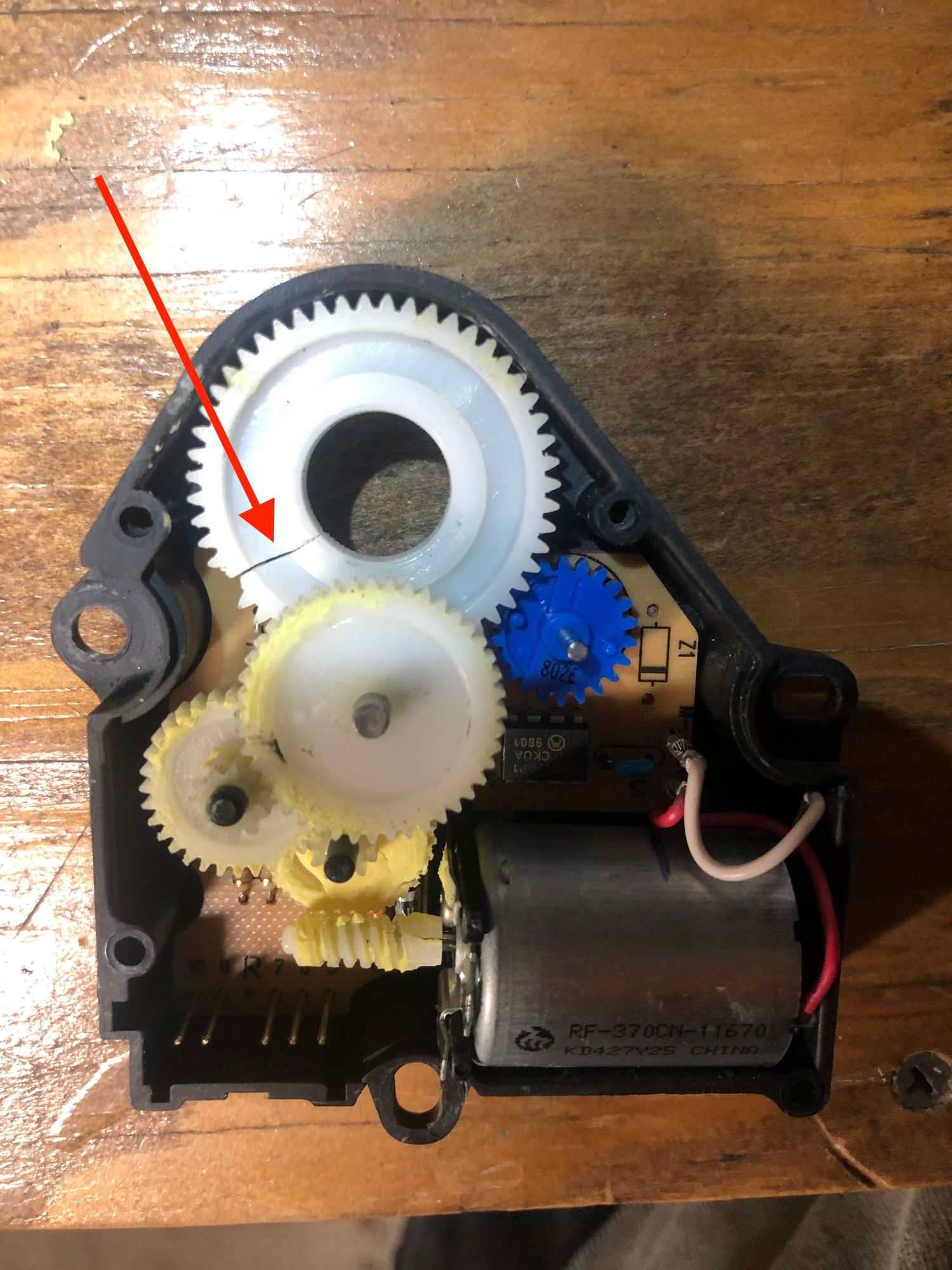

Thought I would share a few photos of my broken right hand actuator ("mix") motor. The big gear was cracked, making the motor run indefinitely since it never reached resistance. I also included some photos of the actuator interior for those of you who may be interested. So if you're hearing a weird squeak or grinding under the dash along with some HVAC codes listed above this may be your problem.
