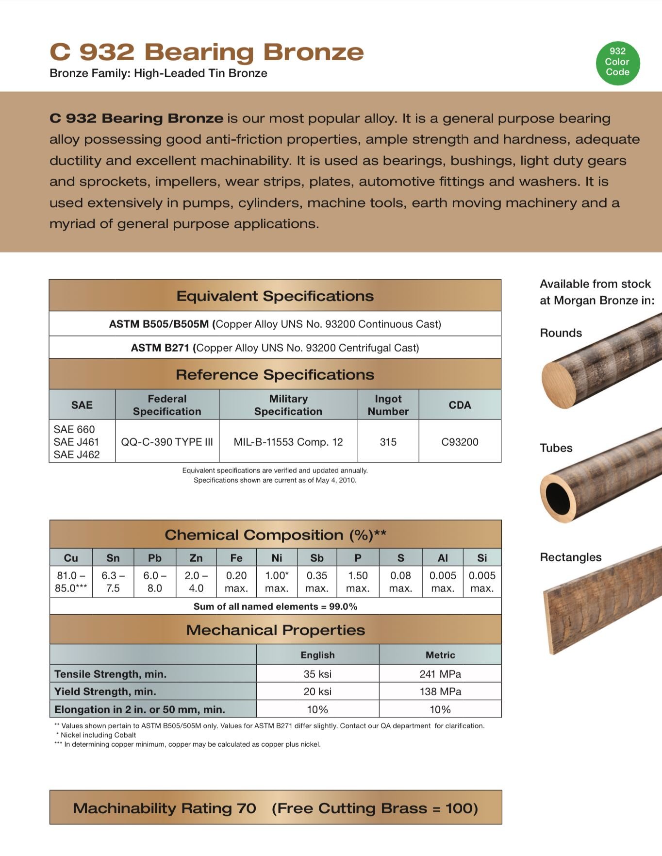

Ron, I don't know what grade of bronze CHE, Straub, etc, are using. But, if it's AMPCO 18 bronze, that's some mighty tough, hard bronze. When you try filing it, the file tries to slide on it with a mild "shriek." Endmills and carbide cutters make a Helluva racket. If they're using AMPCO 18, or pretty much any AMPCO grade, they should last a LONG time. Especially with the constant oil splash feed from the pushrods. My .02......
The BTR website sells the Smith Bros kit and states C932 bronze. I have no clue how that rates. I found the info below on the net…
