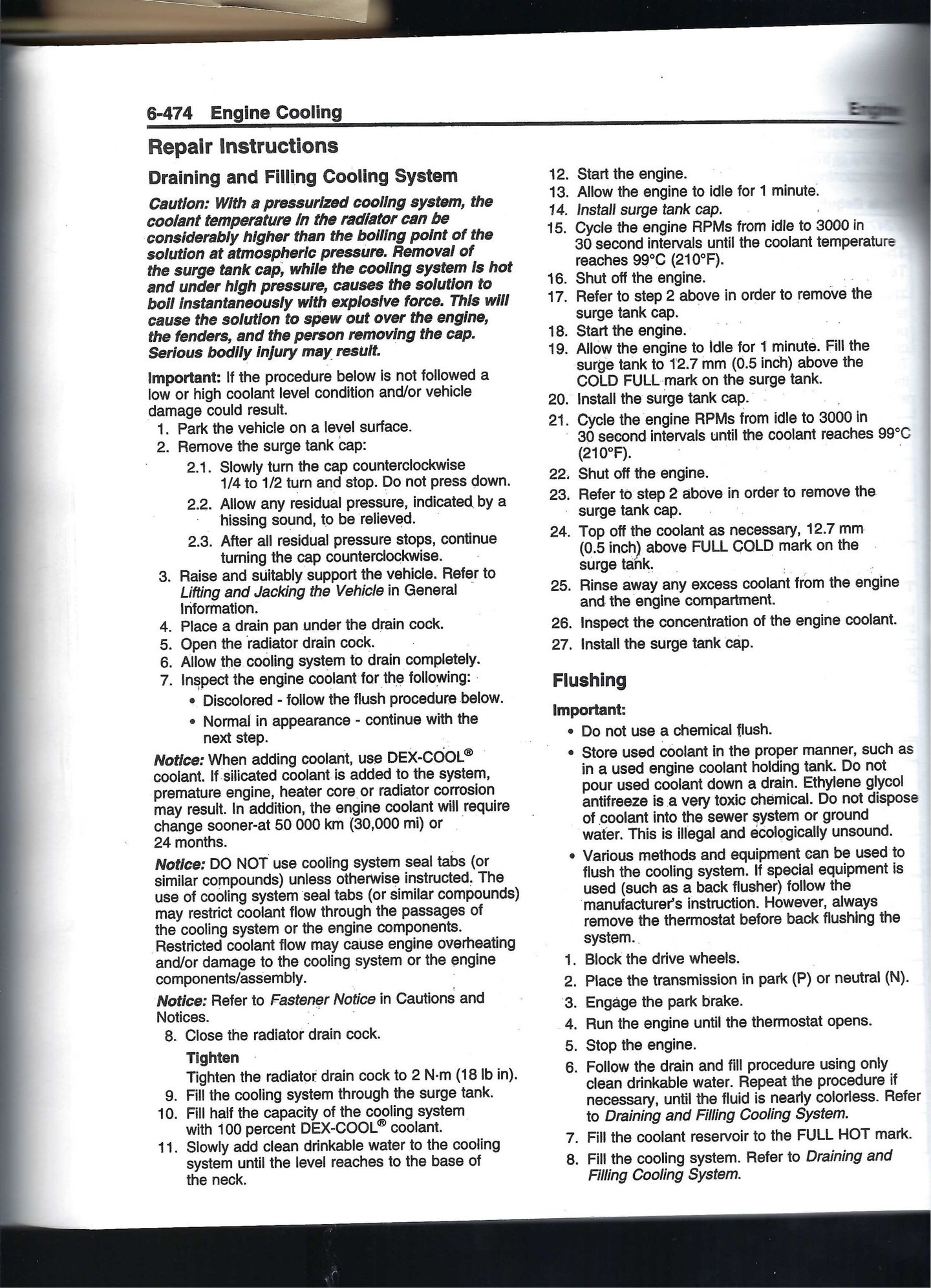

If you change coolant, make sure you perform at least the Factory Service Manual method to get trapped air out of the heads.
