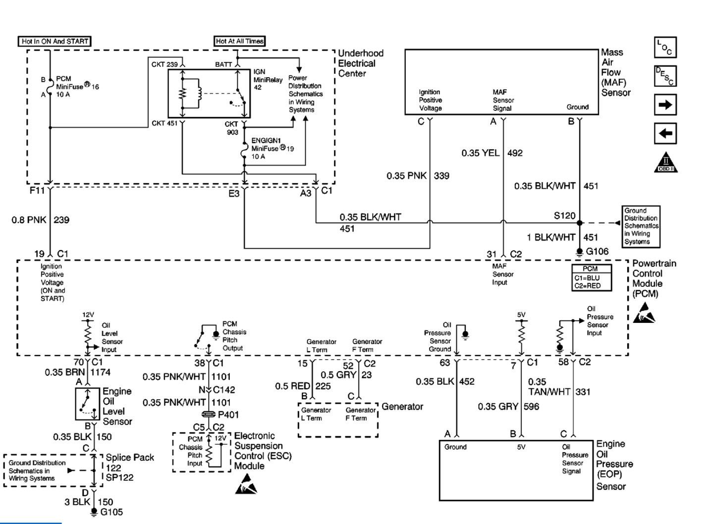

I do not know which year your car is , please put it in your profile.
Here is the drawing in a 2000 .
The voltage signal between A and C shall normally operate between 0.5 and 4.5 volt .going to the PCM input .
Do you have a DTC P0522 (Engine Oil Pressure (EOP) Sensor Circuit Low Voltage )
or DTC P0523 (Engine Oil Pressure (EOP) Sensor Circuit High Voltage) ?
I don’t have either one of those codes.

Have you measured the voltage between ground (A) and Signal (C) ?
I have 18 millivolts from A to C

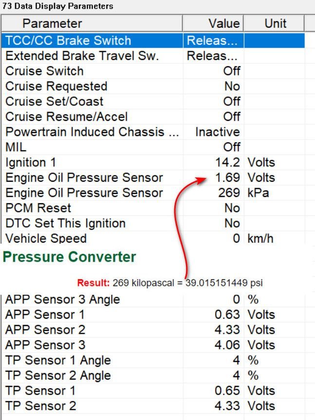

When my car is idling the sensor output to the PCM was 1.69 volt when the oilpressure is 39 psi .
This is according to info from my Tech2 data when my car was idling at approc 655 rpm . .
Check if the C terminal is shorted or your sensor may is bad .
I feel like a dumbass! I didn’t check that with the engine running. LOL. You just helped me out a lot though. So if I check the signal wire to ground I should have anywhere from 0 to 5 volts with the engine running. I’m gonna do that tomorrow and if the voltage fluctuates with the oil pressure changes then I am good back to the PCM?

If your idle signal voltage from the sensor is similar to the voltage shown above and the voltage increases when you increase the rpm (oilpressure increases ) your sensor seems to respond correct
