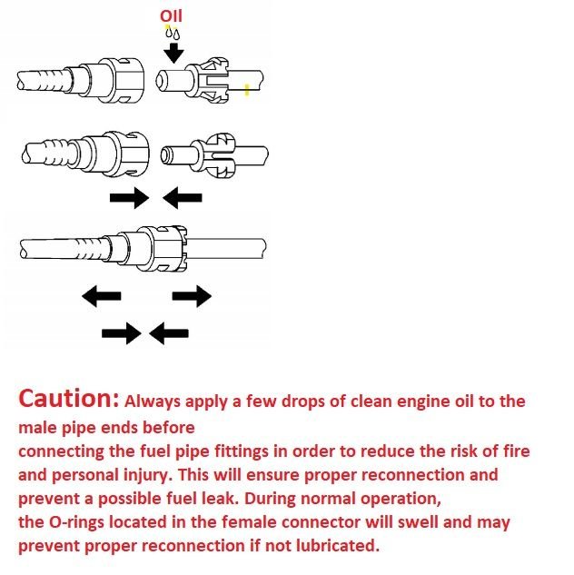

Looking at your photos it appears you were able to get the green fuel line retainer clip seated correctly but if you have doubts then replace the clip.
Note the fuel line retaining clips can be procured and replace separately, just google >Corvette C5 fuel line retainer clips<

Installation note as per the GM service manual;
