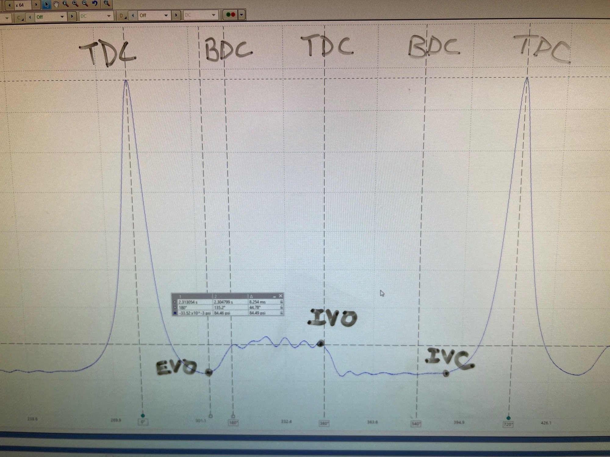

First off welcome to the Forum......you should put a scan tool on the car first (what was the MAP DTC ??) and I would do a compression test but you can do a "cranking compression test" just to listen to how the engine sounds when it is cranking over...put the accelerator pedal to the floor and HOLD it there...the car won't start but listen to any inconsistencies in the cranking cadence of the engine while you start it...should be nice and even...I'd put a vacuum gauge on the car and see what it reads...you'll need a smoke machine to find a vacuum leak so I'd suggest you do that and take the car to a diagnostic shop and ask the shop if they can do an "in cylinder pressure analysis" of the engine...you might have to look around to find an advanced shop that knows how to do it OR bring it to me here in SW Florida...LOL !!!...going in cylinder I can tell when the exhaust valve opens and when the intake valve opens and closes (can't really see EVC) and if any valves are sticking or not seating or maybe a bad cam lobe or incorrect timing (a cam-crank relationship)...this test will tell if anything is wrong mechanically...an in cylinder of my 01 at idle below...my EVO is 44.78 degrees before BDC...I can check IVO and IVC the same way ...please fill out your profile with all your info...model year, mods, tune, etc...it helps us help YOU !!
