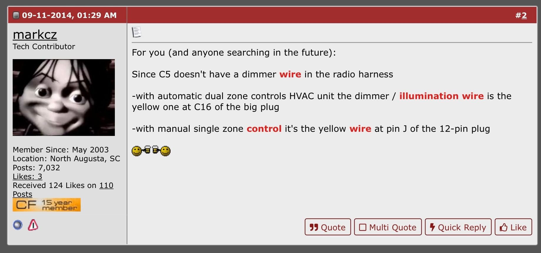

IIRC I think it's the brown wire on the climate control box but let me get back to you
Old Jan 28, 2022 | 10:29 AM
jdmvette's Avatar
jdmvette
Night Owl for life
Joined: Nov 2003
Posts: 24,725
Likes: 4,564
Here you go...yellow not brown ✌️

Good info. I stand corrected.
