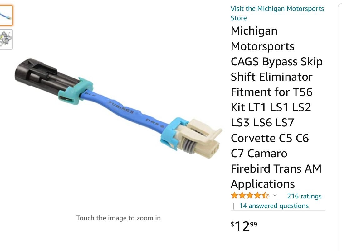

It's called CAGS skip shift eliminator, it's a small wire assembly with two connectors that you plug in at the transmission.

I bought this one on Amazon. Works fine.

It is also something that you can disable by doing nothing but avoiding the situations in which it occurs. First, having a shift forced from 1st to 4th is a rare occurrence, you have to be moving very slowly (like behind another car in heavy traffic). Second, you have to initiate the shift to 2nd between 14 and 19 mph. Third, you have to be using a very light throttle with a throttle opening of less than 21%.
The easiest way to avoid is to shift to second before 14 mph (all Corvettes can handle this from an engine and drive train stand point) or to shift to second after 20 mph so memorize a rule of thumb to make the shift to 2nd at 10 mph or 20 mph and you will never see CAGS activate. If you happen to be following a slow car and inattentively try shifting into 2nd between 14 and 19 and feel the shifter being forced to 4th, all you need to do is move the shift lever forward toward the 3rd gear gate and then pull it into 2nd gear. No need to purchase anything and no need to modify the car. That is probably what the prior owners of the OPs car did for 22 years.
Back in the day, the C5 CAGS eliminators used to be $20. However, even the $12 price shown in the thread is too much. Even a $0.00 cost is too much since it takes time to install the eliminator. Save your money and time (once gone you can't get it back).
