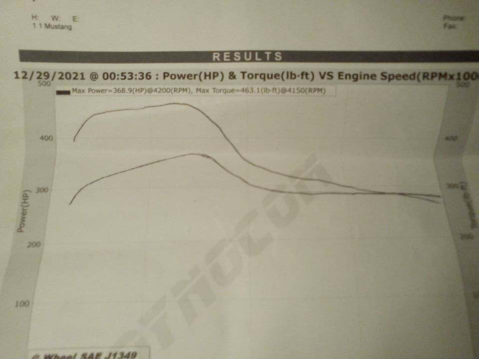

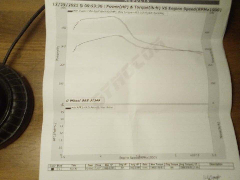

I had the car tuned on a dynocom 5000 dyno i read are dynoqueens and read the highest numbers. Im looking for someone local with a dynojet or mustang dyno to get a mountain or regular dyno graph in the mid 300hp tq range which would normally keep climing. One is a 98 z26 6 speed with stock 3.42s ported tb, manley dual springs, smaller 218 bullit cam then whats in the c5, i dont have exact specs i paid 120$ for it used on craigslist and was told it was ran in a trailblazer ss so maybe an rv cam and hooker open headers made 375whp 375wtq. The dynocom c5 auto dyno graph looks small but has auto 3.15s, factory mufflers, pac-1219s and the 1830 220/224 cam, tsp headers and a volant oval filter. These were two different tuning shops one was pat g in victoria texas a mustang dyno which is further from where i am now from 2011 with the bullit cam hooker headers z28, later s475 turbo 6lbs truck manifold turbo kit, and lsx performance dyno a week ago for the c5 with tsp headers, bigger elgin cam then what i had in the z28 if you ask me just by the sound of it. Lethal performance was booked for a week so i just went with whatever local lsx tuning shop could fit me in. Someone told me the c5 graph looked lean or that the car was running lean over on hp tuners as the power drops off. He told me it was 12.6-12.7 afr to 6k rpm and set up to run WOT 1/4 mile passes to 6k rpm. It says 368 max hp on the c5 but its hard to say youd have to have a run on another dynojet or mustang dyno and maybe thinking or purchasing the aem 140$ wideband to mount in the exhaust to confirm it is indeed 12.6 afr WOT. With the z28 s475 i put an aem wideband in the downpipe to confirm afr and it was at 11.7 when boosting solidly 11.7. I dont have one on the c5 yet as i didnt think itd be needed but may need to to confirm for tuning issues. Im looking to put better mufflers or straight pipes on the cammed, headers c5. Some pilot autozone 2.5"-3" polished tips would look nice out the back.

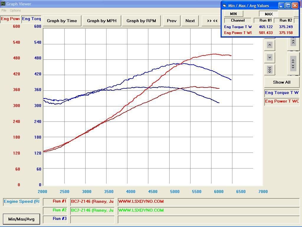

IIRC, my 3.42 A4 runs about 2,200@70mph......
