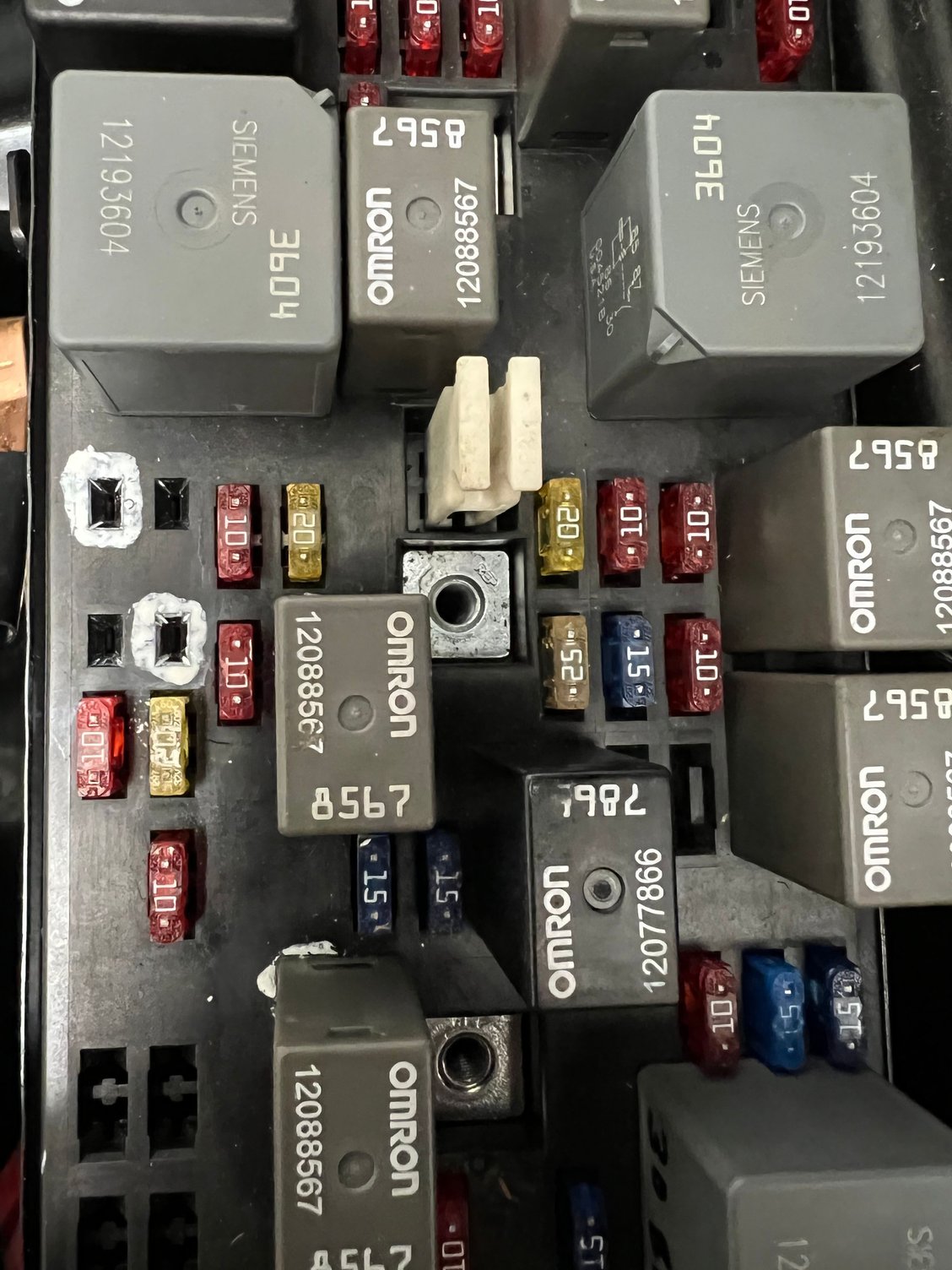

You’ll need a rail rail adapter with a fuel hose attached to it and jumper terminals 87 and 30 highlighted in white of fuse 35 (fuel pump relay)…the fuel pump will operate and you can drain your fuel out !!
thanks, makes perfect sense.
