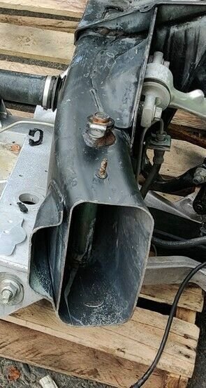

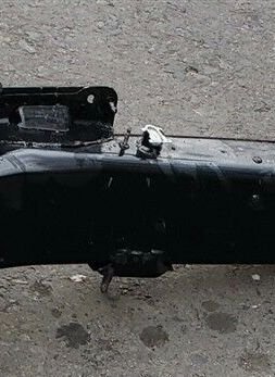

From what I understand, there is a bracket on each of the bolt that secured it on the top frame rail. Inspect those brackets.
Old Feb 20, 2022 | 10:07 AM
helga203's Avatar
helga203
Joined: Jul 2010
Posts: 6,013
Likes: 726
if You broke the nut that's inside the frame you're gonna have to cut the frame to get to that nut. Yeah correct me if I'm wrong guys.
Old Feb 20, 2022 | 10:14 AM
robmiz's Avatar
robmiz
Joined: Jun 2004
Posts: 270
Likes: 67
From: Montana
Found these pictures…
Old Feb 20, 2022 | 10:27 AM
helga203's Avatar
helga203
Joined: Jul 2010
Posts: 6,013
Likes: 726
nice
