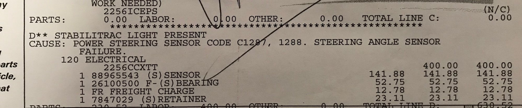

Dealer did mine recently.

Is that just parts how much was the labor bill?
