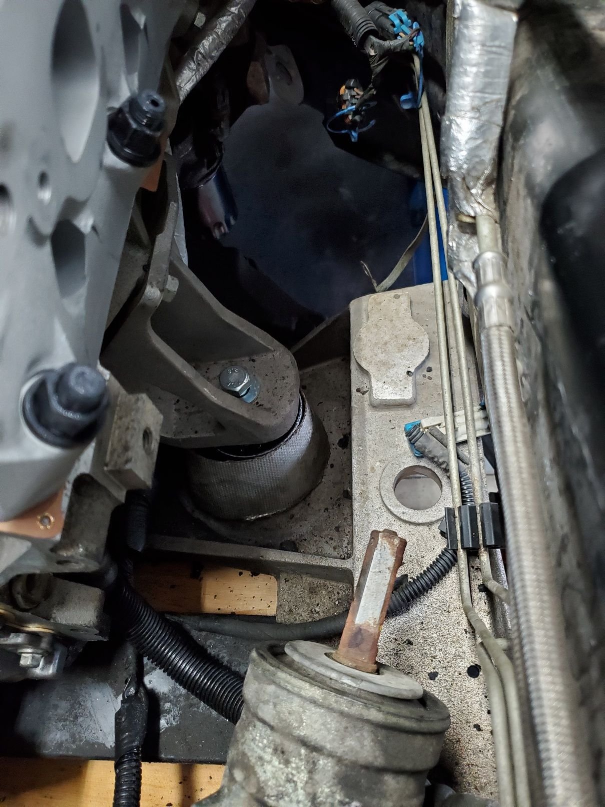

Continuing on my LSA project - I got my HB on and pinned, re-tightened the cradle and installed These Mounts. I was told that a 3/8" drop would cause the Oil Pan to hit the Transverse Spring at Full Droop - It does. I've had the car 3' off the ground with the upper A-Arms unbolted for a few weeks and I am DEFINITELY at Full Droop - plus a little. How much should I worry about this? I don't plan on 'Getting Air' too much when it's all done. The bolts seem to be long enough to fit but I'm having trouble tightening them because of the interference. I bought longer bolts but hesitant to torque them and put too much force on the Pan.
What say YOU?
Tomorrow's job is getting the FEAD stuff back on and the Rad / Fans in. Front & Guts done - Then... the Torque Tube.
Thanks for any help - I swear I'm gonna start a build thread on this - I don't want to keep HiJacking Mr Black's fine work. He's WAY ahead of me in this race. Hell, I can't even see his Tail Lights.

I put my A-Arms back on today but the suspension is still hanging pretty low. Spring is touching the pan but the mounts are mot movable so it's JUST touching. Still can't get the bolt thru but I think it is just too short. I can't get the right metric bolt (M12-1.75) locally so I got some 7/16's that are long enough - they are close to the Dia. of the Metric. I don't want to tighten anything till I'm sure I wont cause a bigger problem.
TIA for any advice.

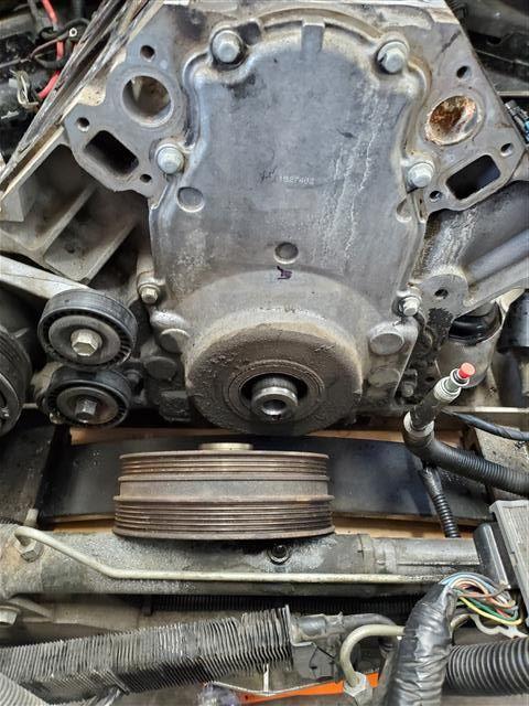

I was a rebel and refused to remove the Steering Rack for my Cam / HB swap. I found guidance here - this is a GREAT PLACE! So I lowered the cradle and lifted the engine which worked out for me because of the Engine Mounts. My car has been 3' in the air for weeks and my upper A-arms were unbolted so I was REALLY hanging low - it'll probably take 10 days for it to settle once I get it on the ground again. I think you can swap mounts if you unbolt the bracket from the engine and lift it a little and NOT drop the cradle - someone else might confirm / deny that.
I got them from LevelZero Motorsports - an Ebay purchase - they were $130 in 2019. They are Poly and appear to be a Hinson Knock-Off. Very nice work and the guy will make them any size you want. I don't see them on his store currently but you can always ask.
I am still worried about it hitting the pan - there is a lot of info here -
https://www.corvetteforum.com/forums...ts-issues.html
And it also links to another discussion - C5 & C6 are the same mounts and same Oil Pan issue. Some say don't worry, some refuse to let it hit just on the principal of it. I'm still undecided and I don't see the point in the cradle spacer. That just raises the body and if you lower the engine then why not just let it all stock?
My original question was about adding stress to the pan and causing a leak or cracking it. Seems that it only touches a small part of the spring (about 1") so it's not fully SLAMMED up against the pan, just the edge where I would think it is very strong.
I Hope this helps you. But if you have a choice... Listen to RonSS before me.
Here's proof that it CAN be done but after looking at the pic I don't see interference where the spring is in relation to the pan. I'll have to look closer - I do know that it IS hitting something, somewhere. the cadle might be down and a bit forward when I took the pic.
