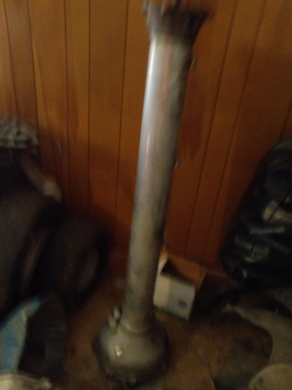

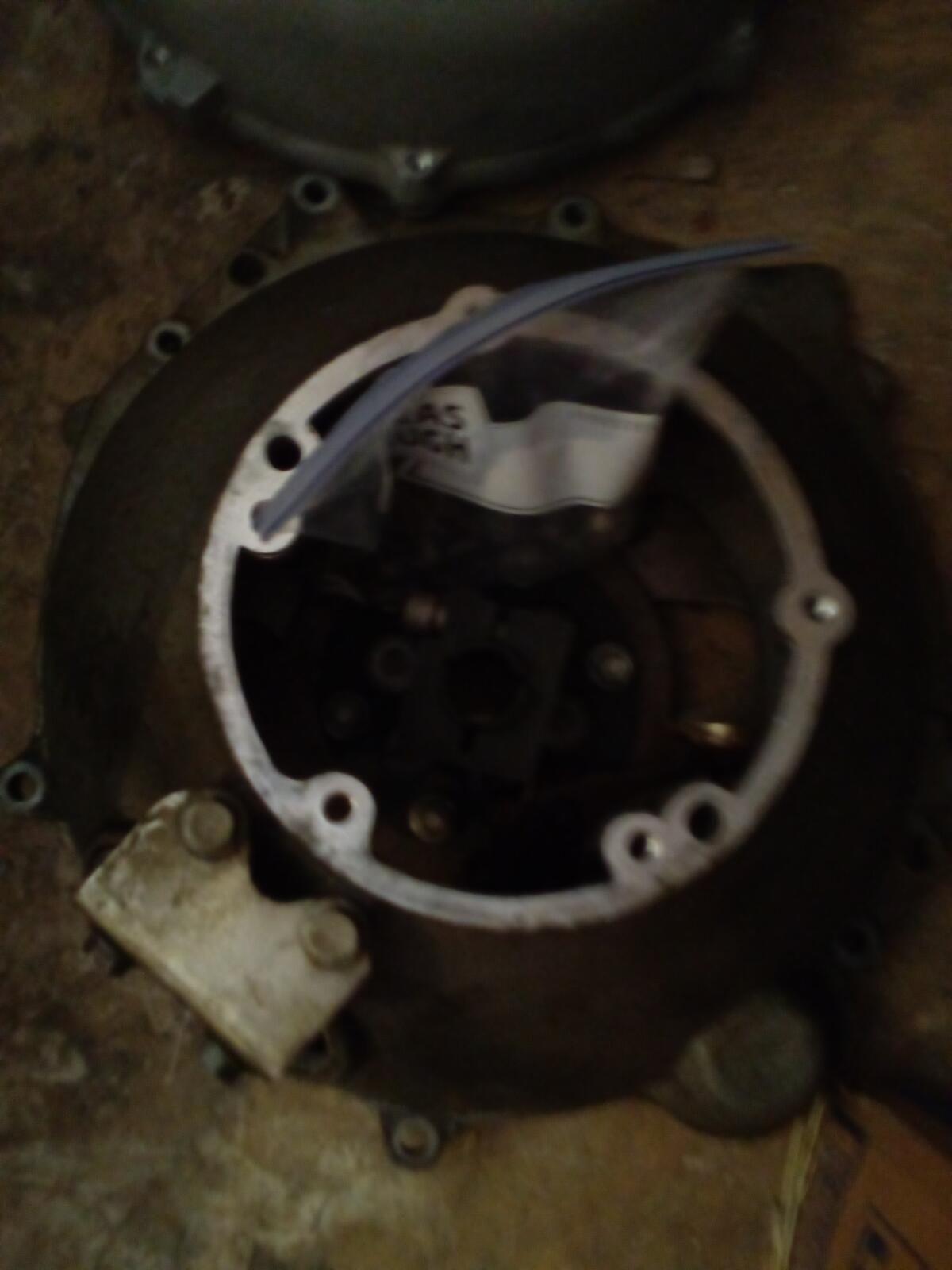

Heres the 02 auto torque tube i picked up complete with front bellhousing, hub clamp, flexplate for 100$ its in good shape if the 99 torque tube i just rebuilt with solid 10mm couplers goes bad. I had paid 126$ on ebay from tpi parts for a 98 driveshaft as mine was in bad shape last summer so 100$ is a good price for a good complete auto torque tube.
