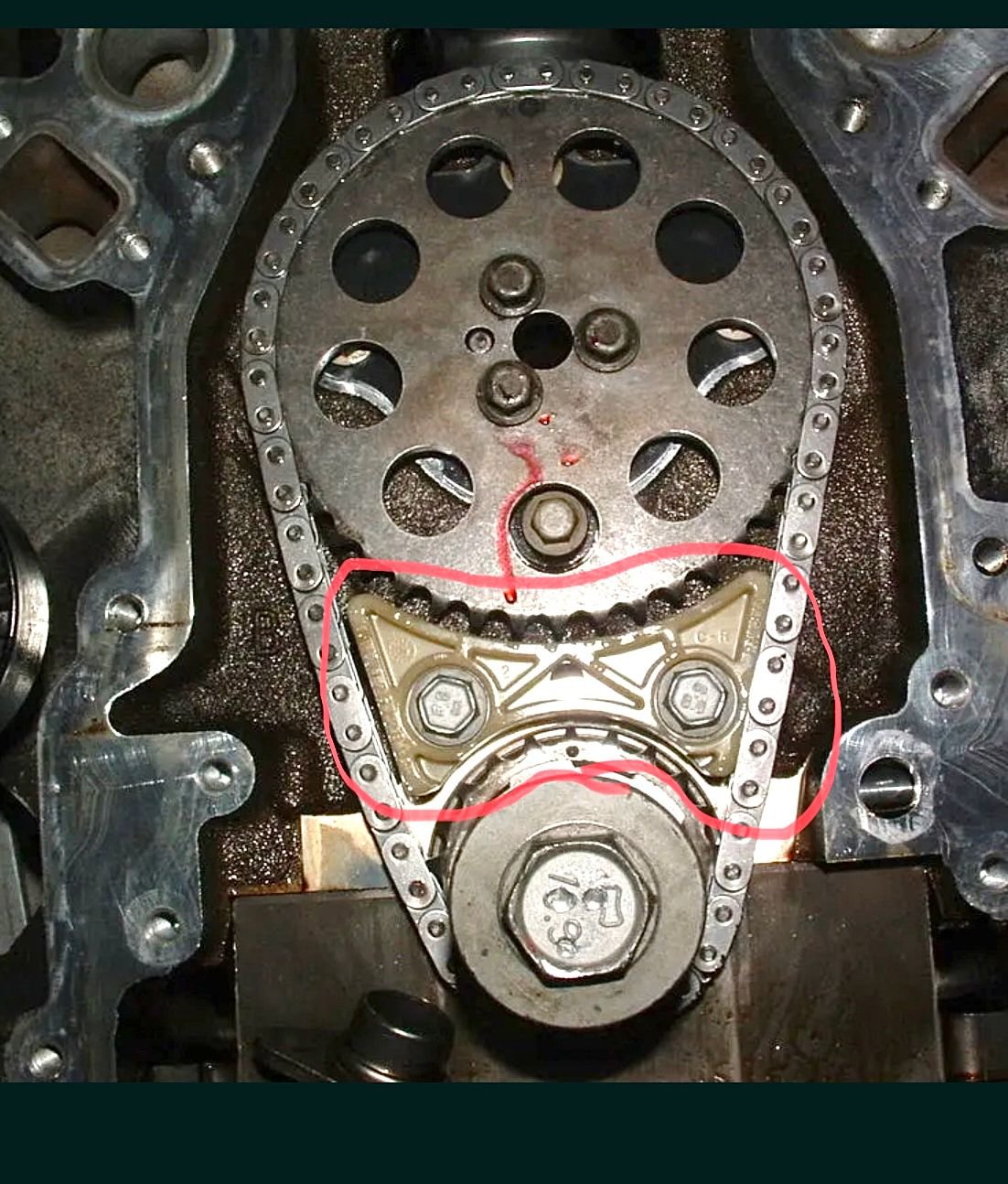

I recently learned that the timing chain dampener is there to protect the chain from whiplash when shifting aggressively. Evidently, the sudden drop in rpm between shifts, combined with subsequent demand for more rpm yanks pretty hard at the timing chain. So this little $20 chunk of plastic helps protect the chain in that regard.
There are two models, the earlier of the two having less robust materials and a narrower bolt pattern. The change to the upgraded part took place near the end of the 2004 run, but I’m not sure where that leaves me exactly…
Its not my intention to turn this thing into anything but a reliable driver that can deliver, and withstand, an occasional 5000+ rpm on-ramp blast. So not going overboard, but don’t intend to ignore a cheap part that might save my ***!

The dampener is the bat wing shaped part circled in red. From here you can see how it can keep the chain from flapping back and forth.
