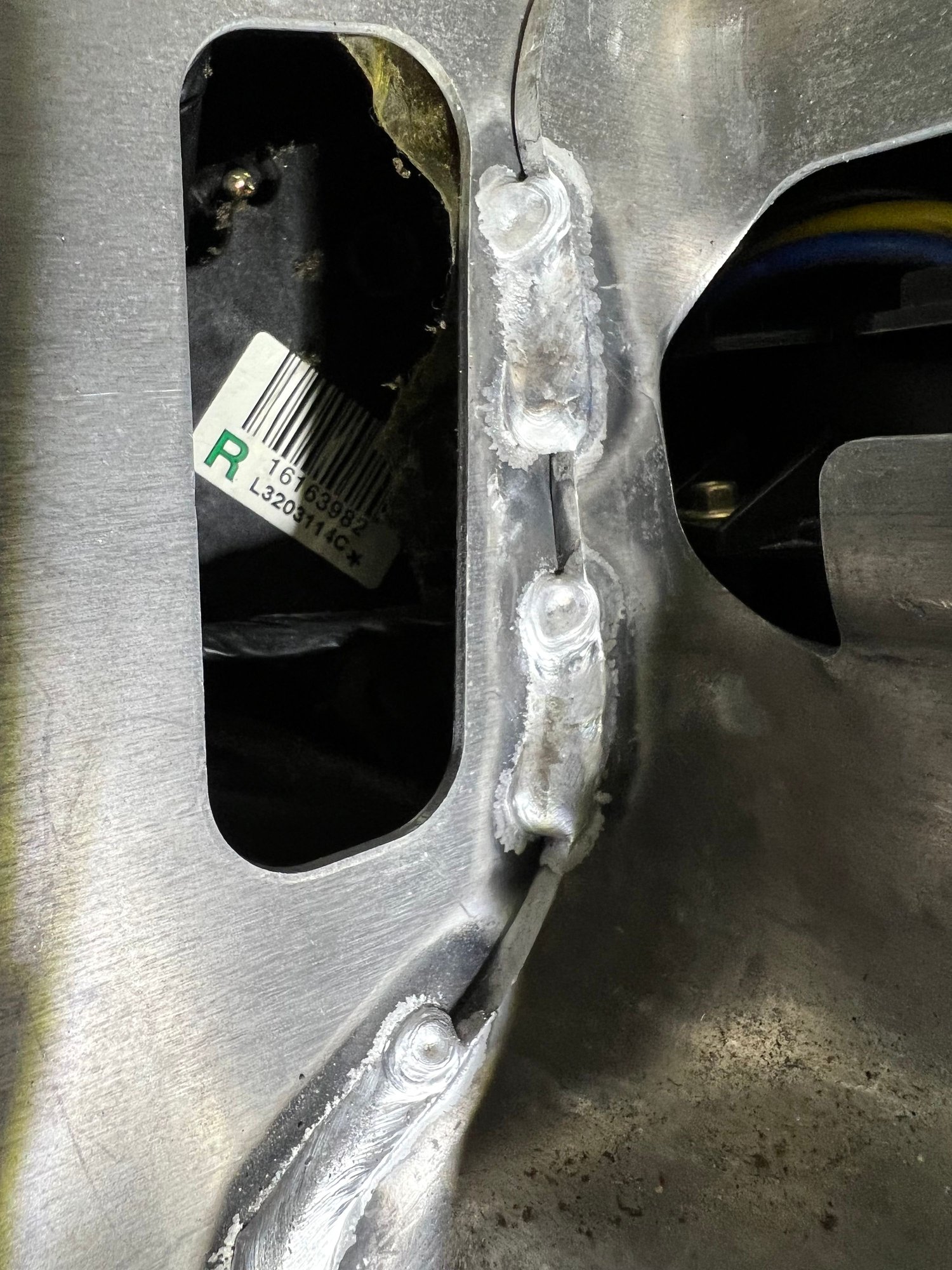

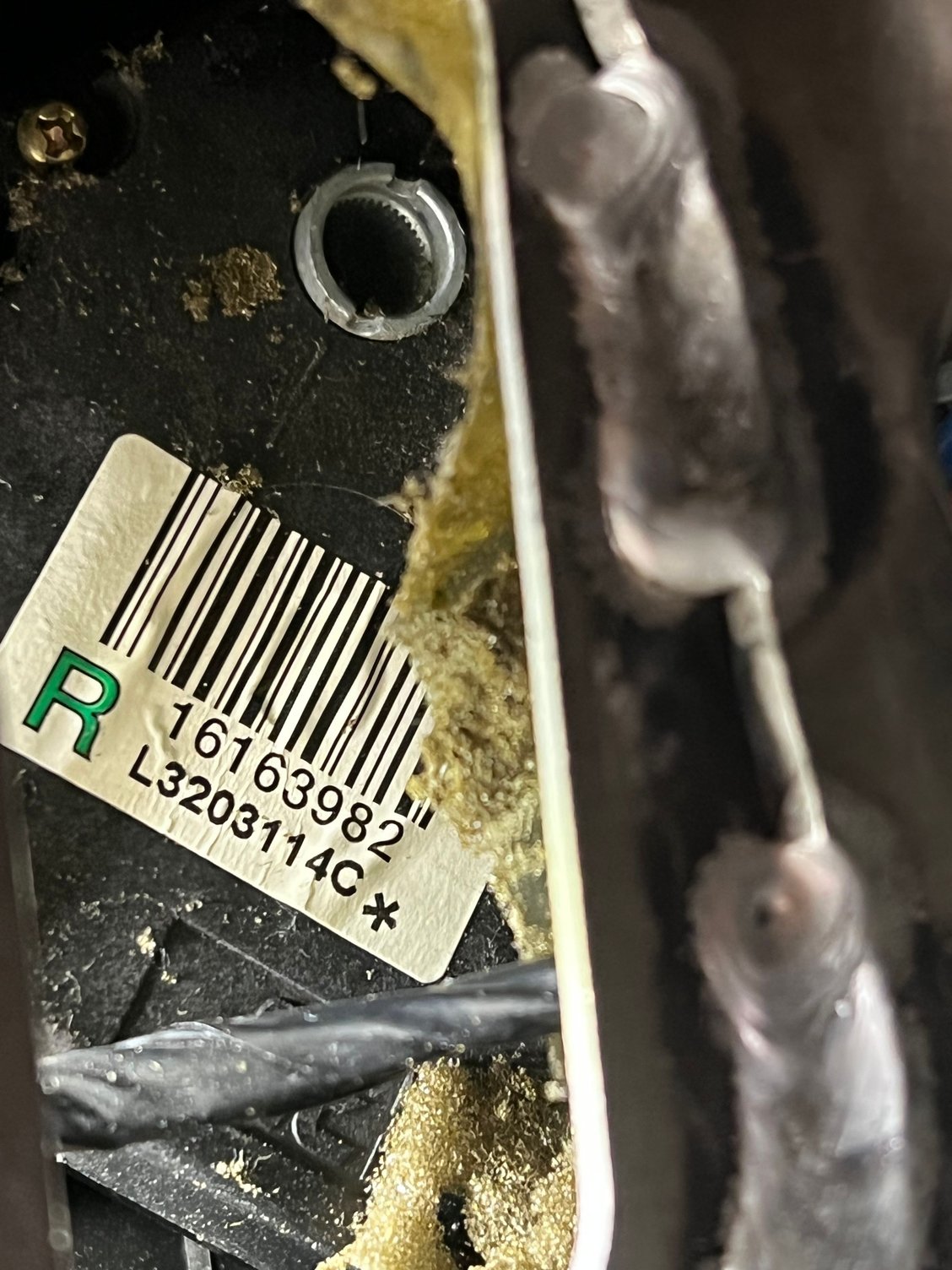

First any current DTC stored ??…with drivers side hot or warmer and passenger side cold it can be low on Freon but instead of your shop just checking the pressures (which they most likely did) did they do a recovery and then add the correct amount of Freon ??…with a bi directional scan tool which you probably don’t have you can check the HVAC outputs and check the actuator feedback circuit in “counts” as it’s called….voltage can be used instead of these “counts” so you can see if things are working electrically or not…you can check the passenger side motor and see if it is responding to the temp setting on the HVAC head…you’ll have to remove the glovebox and if you look inboard (see pic) you can see the motor splines…see if it rotates as you increase and decrease the temp setting…moving this to Tech !!…also NOT a big fan of Dorman parts !!

I appreciate the responses. I did the acuator reset and I was getting cold air from both the driver and passenger sides. I took the car for a two hour drive and this is what is happening. The passenger side blows hot for about twenty minutes then blows cold air for 20 to 35 minutes (I checked there is no set pattern) and then it blows hot air again and after a few minutes changes back to cold air. The driver's side blows cold air all of the time. As I stated earlier, both actuators have been replace, the freon has been checked by a shop. no vacuum leaks, and have replaced the climate control module (it was rebuilt one from Ebay)
