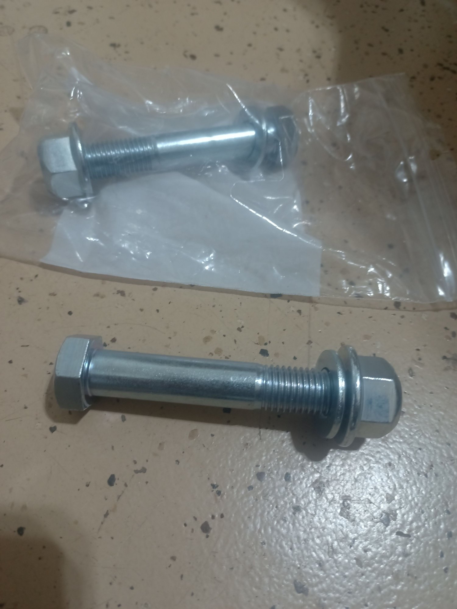

Hi .. looking for rear lower bolt with nut l know the part number bolt (14048990 and nut 11516383) But that discontinue any (bolt with nut) can replace that ? Even with ARP bolt part number ? Thanks

There is no ARP bolt for that size so I end up with buying those heavy duty exactly the same size bolt from the bolts shop

I am replacing my shocks and lower mount bolts. But bolts are hard to get.
What is the total length of this m16 bolt? And the length on the bolts area with no threads?
Anyone know what was the steel spec on the OEM bolts was.. 8.8 or 10.9 maybe ?
Old Jul 9, 2022 | 04:08 AM
RockaRolla's Avatar
RockaRolla
Joined: Aug 2021
Posts: 59
Likes: 56
Correct size is M16 x 100. I bought a pair of 10.9 hardened steel. A good advice when sourcing these bolts is to contact a tractor repair shop. They have in stock or can get bolts in most sizes. And they often use 10.9 hardened steel.
