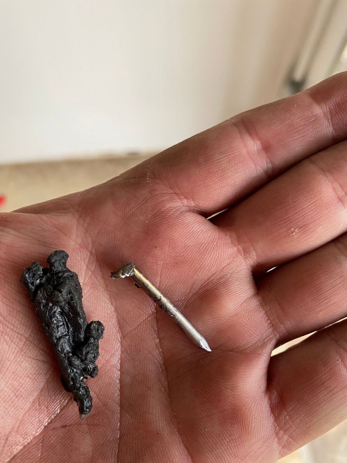

I ended up plugging it last night. I still had to end up buying a Jack and removing the wheel as I couldn’t get enough leverage to push the probe trough the tire with it still on the car. While this is my first Vette I’ve built and raced cars for decades. I’m not the kind of guy that babies my cars or is afraid to run them hard. I bought this C5 basically to see if we would like a Vette before stepping up to a newer or more expensive Vette if we decided we really liked it. (Although I like the C5’s And C6 looks best of the newer styles)It’s been babied by it’s previous owners. The OG owner was a service manager at our local dealership, he kept a log book of everything even when he drove the car. When I took the wheel off it was marked with date and mileage of the tires. They were 8 years old but only have 4500 miles on them and have been stored inside and in climate controlled storage. I’m gonna buy new wheels /tires soon anyways if there are any problems with the plug I’ll report it back on this thread. It had a roofing nail in it which was no surprise to anyone living in this part of Florida. You can’t drive around the block and not see 3 roofing jobs going on. The nail removed and remains of cut off plug.
