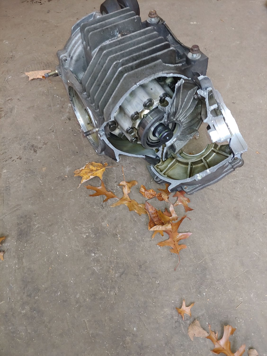

Last track day was September 2020. 428rwhp/390rwtq- 4.10 diff with hardened output shafts grenaded on my first pass. I was on street tires and had an anxious launch so I'll take most of the blame.
what was the cause of this mt et streets tires or hp? 6 speed off the line clutch dump or auto? I dont want to damage my 3.15s Mine is only 368whp. Are the 4.10s thinner gears did you strip the ring gear or pinion or housing grenaded who built the diff?
The gear broke teeth as well. This was due to an anxious clutch dump (I knew better) on 18 inch NT555 street tires, not DRs. It was a ring and pinion swap with hardened output shafts. Not a "built" diff like you'd get from say RPM.
