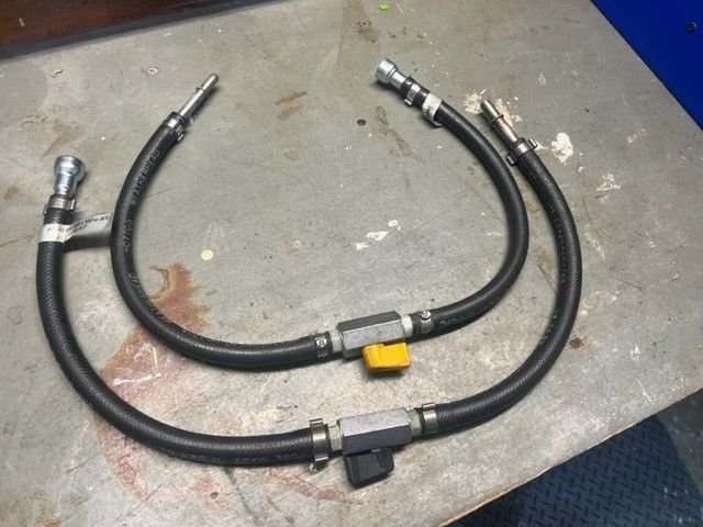

Is this the line you’re talking about? I was able to find a good used one. I need to buy a fuel pressure gauge. I sometimes get long cranks when the car sits overnight. I’ve heard the check valve in this line is known to stick.

Sorry I just researched the location by diagram so couldn't tell you for sure. If that has the check valve and its in the feed tube then yes.

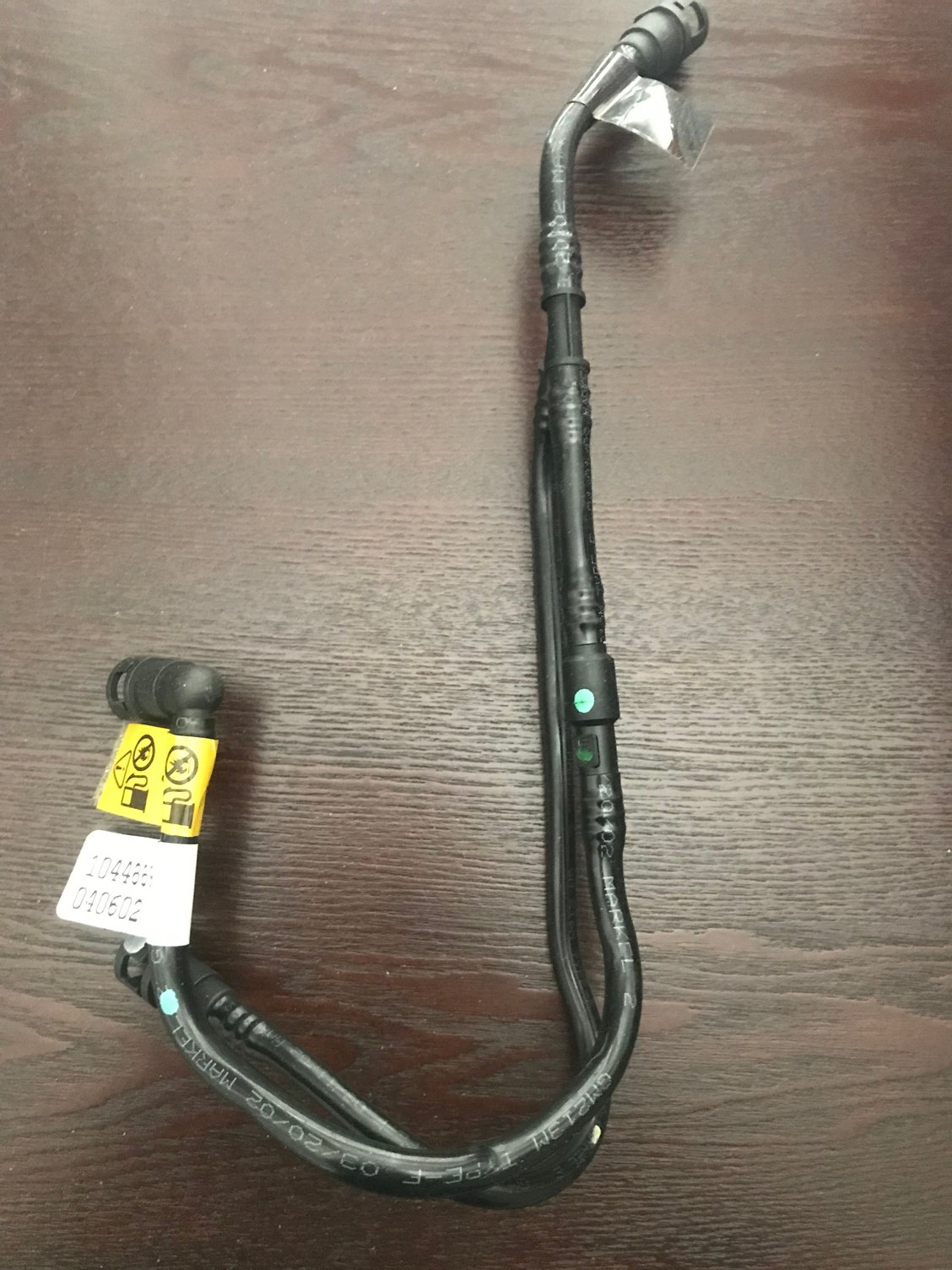

How "exactly" did you narrow it down to a bad check valve ??...there are 4 or 5 components that may be bad causing this rapid drop in pressure...this is the easiest way I've found to diagnose this issue...my Mityvac with a 3/8" fuel line fitting...apply 15 psi back to the check valve and the pressure should hold for 1 minute...you will also need the Kent Moore J37287 specialty tool to check the other components or this can be locally made.
Kent Moore J-37287 adapters
