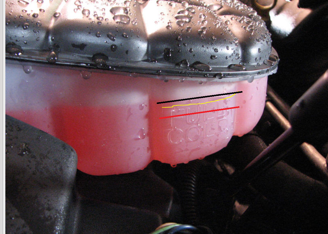

Ignore the yellow line please, it came with the photo.
The black line is where i filled it up to, and the red line is where it sits as of this morning. I will check it again when i get home.

You will typically notice about 1/4" or so level higher when hot than cold. Could be a little more - point is that hot and cold levels are different. If you were low enough to get an air pocket in the engine, I would expect the first time or two to have a greater delta because more would have been drawn into the engine when it cooled.

The expansion tank should be half full, COLD. Check it and add as required before every drive (engine COLD) until it stabilizes.
