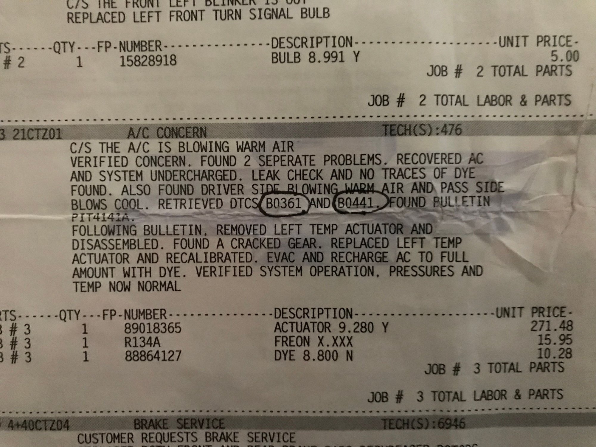

These are the common codes for failed blend doors. Had mine fixed back in 2008. As you can see, there is a dealer bulletin on the issue. Back in ‘08 my car only has about 20k miles. You can see how quickly these failed. Also, just because there is warm air and an undercharged system does NOT necessarily mean there is a leak. The dealer didn’t find a leak. Changed out the blend door and filled the system. All was good for several years thereafter !!
