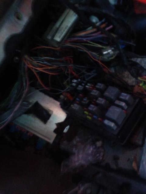

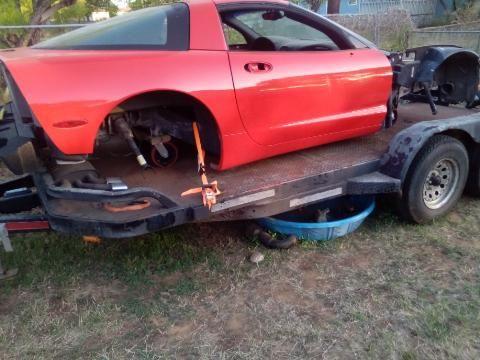

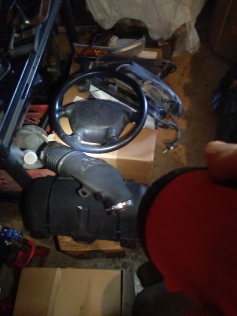

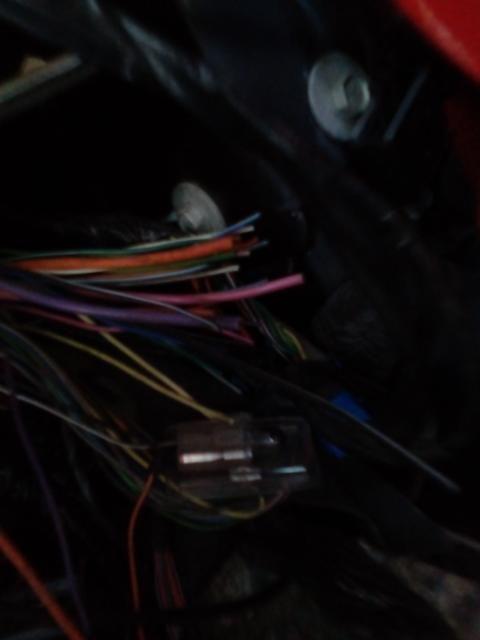

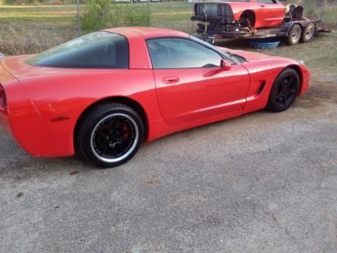

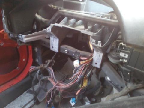

My father bought the whole frame and body parts from the car i was asking about how to remove rocker panels a few months ago. The guy he bought it from used the parts to build a factory 5 gtm supercar, control arms, steering column, engine and pcm as well as door regulators and some of the harness. He cut the pcm harness but left the stock bcm. So to use the bcm the steering column would have to have the correct key chip for the car to start. This ones a clean title 02. It came with the front foglights/plastic bezels, instrument cluster, fuel door, 2 stock intakes and air bridge but the fuel tanks were used on the gtm supercar i think or maybe he had sold them.
I found the control arms are 150$ each so about 600$ to just get wheels on the car. Came with both front and back cradles would just need the ebay control arm set-ups. The guy used the window regulators for the gtm supercar. No front fenders or bumper.
I did purchase the 02 torque tube with flexplate/hubclamp for 100$ and rear diff 2.73s, trans, stock converter, airbag, heatshield for my 99 as spare parts.
Would it be better to find a wrecked roller for 2-3k with steering column control arms and use that bcm and other wiring harness or outsource from corvette salvage yards.

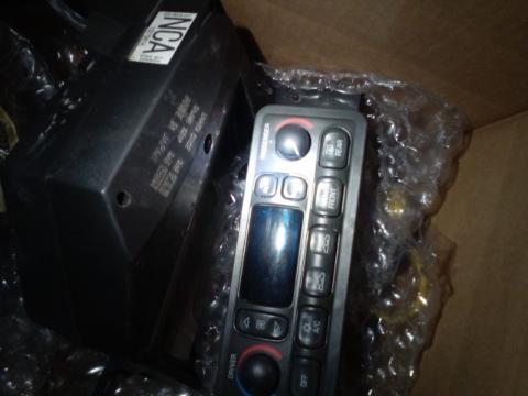

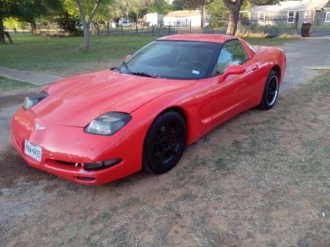

Heres what we're looking at. I decided my 99 rebuilt title is the same paint color. All this stuff is in good condition. Included the good 02 ac head unit, Heads up display and stereo. My 99 wont play cds i think the belt broke i may try to install the 02 stereo in my 99 when i get to it if not an aftermarket single din stereo. Included 02 ebcm and bracket so most of the brake lines are there.

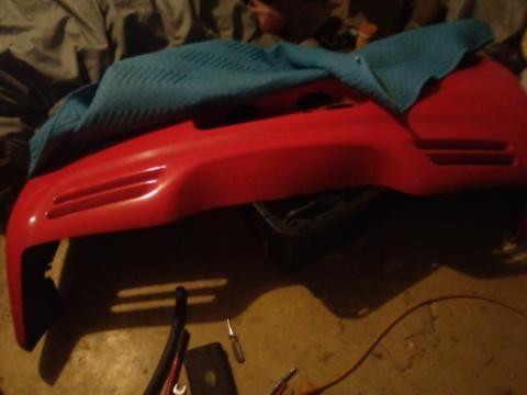

The problem is placing alot of the dash wiring in place but most of its there with instrument cluster. The guy he bought it from had removed the dash that dad to sell me the airbag for 70$ for my 99 as mine was wrecked in 2010. I had bought the airbag, heatshield, sunvisors, and some performance choice shale floormats for 110$ from the guy and 30$ for all 3 service manuals for a 99 corvette as well as a good 02 torque tube for 100$ as mine had got tore up last summer the bearings are held in with c clips and easier to change in the rear carrier so i didnt get to replace my 99 rear torque tube carrier bearings last summer as the bushing is in the way of the bolt the seperates the rear carrier splined assembly. Tried a slide hammer. The guy was interested in selling me the right side rocker panel if i only knew how to get it off. I decided im probably just going to repair the front parts of the rocker panels but yes they do feel brittle in time depends how the car was stored in a garage or heat.

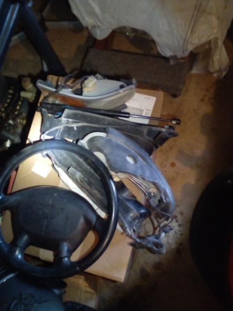

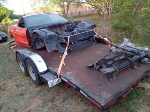

Heres whats left.
The GTM Supercar kit is engineered to be built by a person at home with regular tools. The GTM kit gives you everything you need to build your car, except for running gear parts taken from a 1997-2004 Chevrolet C5 Corvette and a transaxle. The major Corvette parts include the engine, front and rear control arms, suspension/brakes, and fuel tanks. The transaxle used is a Porsche 911 unit or a Mendeola 5 speed.
