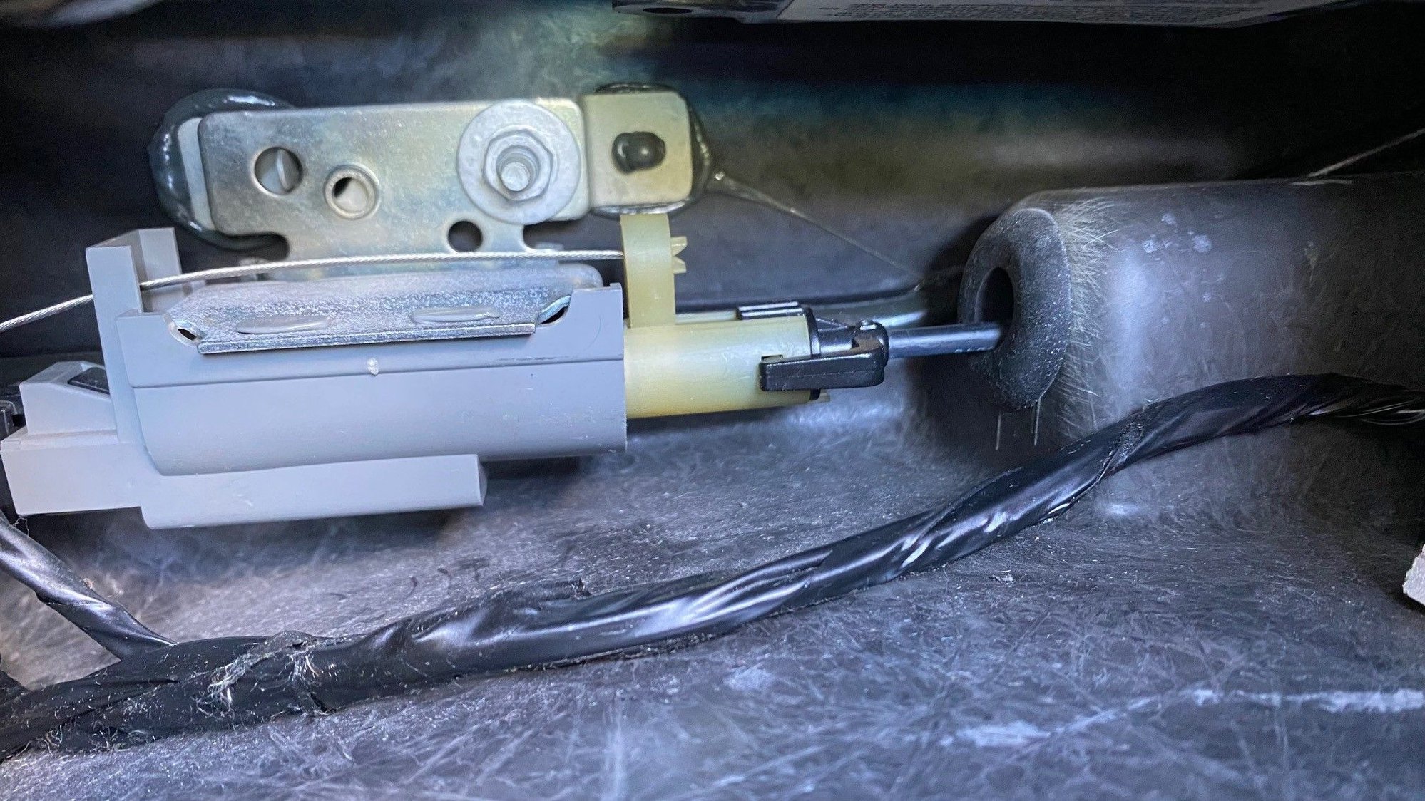

Actually I have full access to the solenoid from the inside of the trunk in my convertible. Really is no need to pull the liner. I did push the liner out of the way and fit my hand in there.. but the whole thing comes out from the inside of the car.
Fuel Door Latch Solenoid

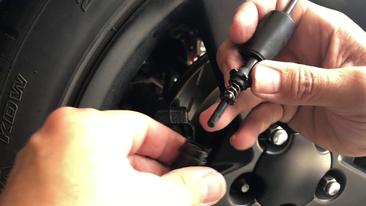

I have a feeling you're messing with me. But here's a picture anyway.

Thank you!! Actually I needed this picture and the details on detaching it to help me understand that you were not just assuming I could pull it out. Did not want to go through the work only to be dead ended. So to be clear.. when this comes apart.. The plunger housing and nut are still attached to the fuel door housing and this slides right out?
I was able reach in and slide the rubber sleeve back and felt around for something to unclip. Do you have details on how to unclip it once the rubber sleeve is pulled back?

Yes, the front half of the housing remains on the door because the nut holds it there. Take a screwdriver and pry off the tabs on the front portion of the house. Be really gentle you don't want to break the tabs.
To Help opening the Gas Door. Stuck

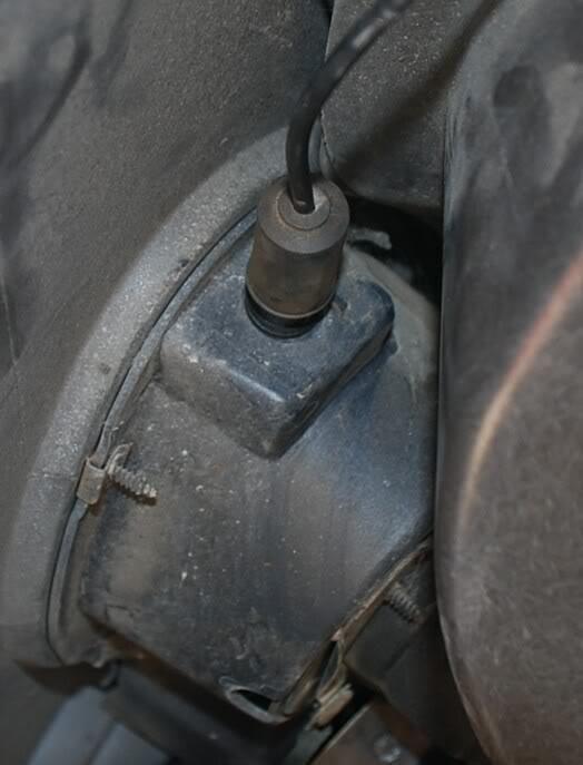

So I finally got around to fixing the door..What a pain in the ****! Remove the Wheel, remove the liner.
I reached up there and felt for the clips on both sides and simply bent it sideways until it unlatched from the housing. Is was clear what happened to the cable once it was apart. The cable slipped out of the little slot behind the plunger. So even with it all apart.. The door was still being held by the plunger which was still in the housing. I took a pair of needle nose pliers and grabbed the back of the plunger and the effing door finally was open. I then had to remove the nut and pull the housing. Since nothing was actually rusted or broken.. I simply reconnected the cable and snapped the assembly back together and reinstalled.. Working fine.. I can only think that when I pulled the manual release in the trunk, I may have pulled to aggressively thinking it was the tonneau cover release sticking. However the solenoid does also engage with hard thump.. So whatever.. Its finally working and I appreciate all of your help here.
