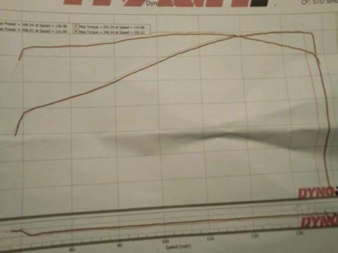

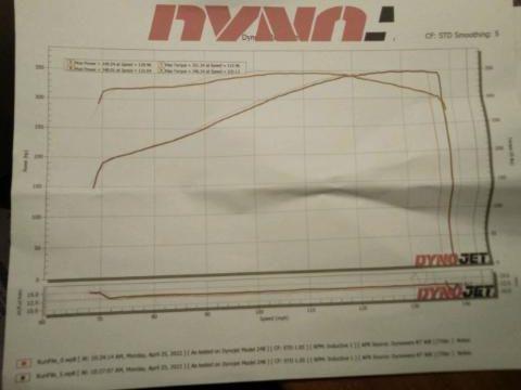

I went to a different shop with a dynojet 248 and wideband AFR log to confirm the tune was correct from the other place i had it dynotuned on a dynocom 5000 eddybrake dyno.
The car is auto 3.15 gears 99 corvette 1839 cam pac 1219s, tsp long tubes and stock 2.5" h pipe exhaust better flowing muffler setup with volant oval air filter. He said AFR was correct 12.5-13 tops and made 349whp 351wtq. I think it could use an ud pulley for 10hp and ls6 intake if they do add 5-10hp. Any other bolts ons that would add power? About maxed out my 6 speed 3.42 98 z28 with a smaller but similar cam, hooker headers, free flowing exhaust, ud pulley made 375whp 375wtq thru the stock 7.5" 10 bolt.

349whp/ 351wtq 12.5afr-13 max
