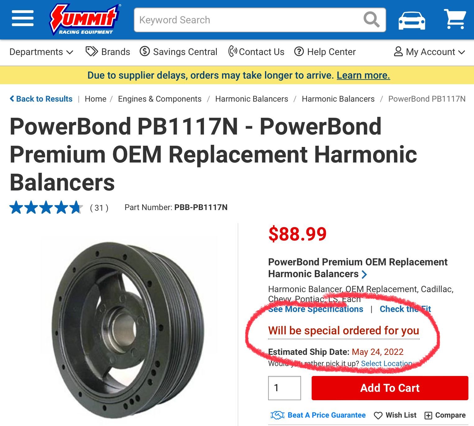

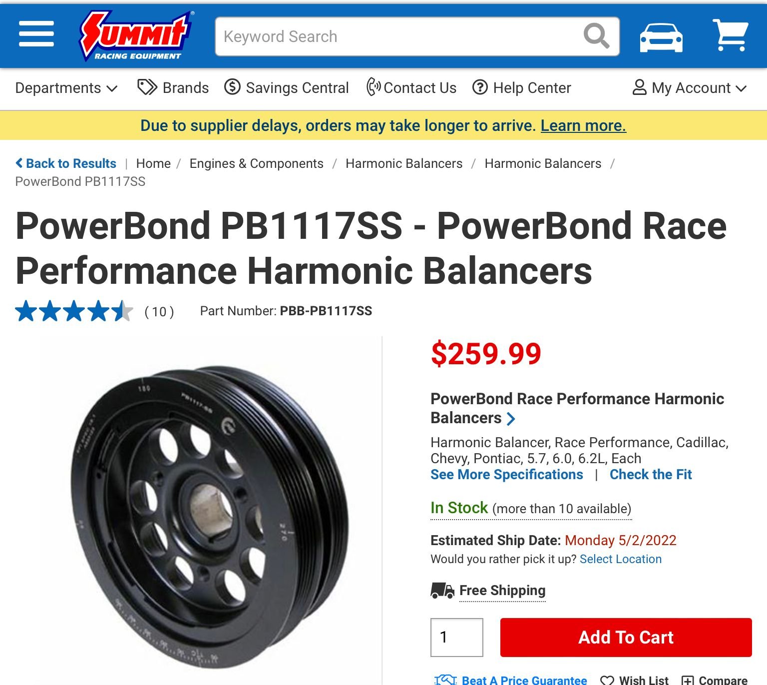

Since the fans will be out, they might be good guys and carefully blow some compressed air through the radiator/condenser to clean road debris out. This is an oft-overlooked maintenance item.
You may wish to avoid installing another GM balancer in favor of an aftermarket brand, such as Dayco/PowerBond. They sell two models, and the less expensive of the two seems to be popular. However, you may have to wait a few weeks. Their SS model costs more, but is an upgrade and more readily available.
