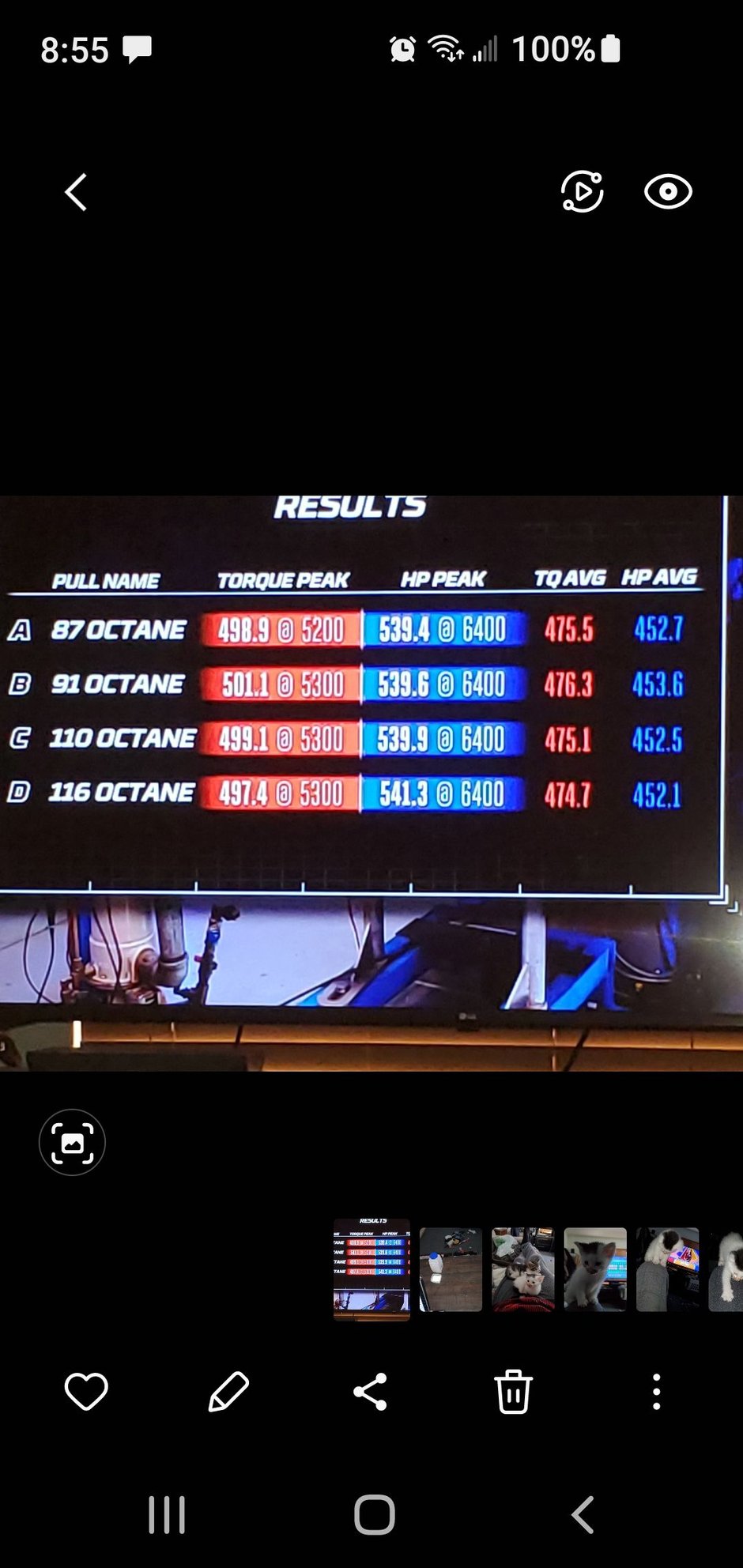

Something interesting.
1
Motor Trend did n experiment with just adding oct will it increase hp.. With 87 oct 29* As the oct increased it went from 12.5 af to 13 af but didnt change because they were proving a point will adding oct and no timing added nothing. i guess back n the day when we use to fill up with 112 oct we were tossing r money out considering it was 100 x more expensive.but i swear r cars and bikes went faster. but it turned r exhaust pipes white. so we had guys come up to us and ask about what fuel we were running. That was cool when 16 ,17 yrs old.

Best power and mileage usually are obtained with regular, 87 octane fuel. Not necessarily on Corvettes, though. My point is, any increase in octane over and above what an engine actually requires reduces power and efficiency! Think about it. Regular gas has a lower flash point than premium. Some would say it's more volatile/explosive. But if you're running a lot of compression, it will cause detonation/spark knock. Premium isn't as volatile. It burns a bit slower, which is why you need to advance the timing a bit. But there's less chance of spark knock/detonation......

These engines have low 9.1 to 9.5 compression ratios No need for anything higher than 91-- 87 will work but remember it is cheap crap gas---and I would not run it in a Corvette
Leaded gas will foul your 02 sensors so I would never use it
One more thought if you want to run higher than 91 is if you run lots of timing However the LS heads do not require lots of timing and at some point will make LESS HP/TQ because of too much timing Look at the data logger and NOT the tuned timing tables The data logger shows ACTUAL timing not commanded timing There can be several reasons for timing to be removed--hi IAT readings / knock /Burst knock etc
Typically I see the best results with about 23-25* of actual timing at WOT

2024 C7 of the Year Finalist - Unmodified\
That looks like the graphs from Engine Masters. That was a good show on octane results.
