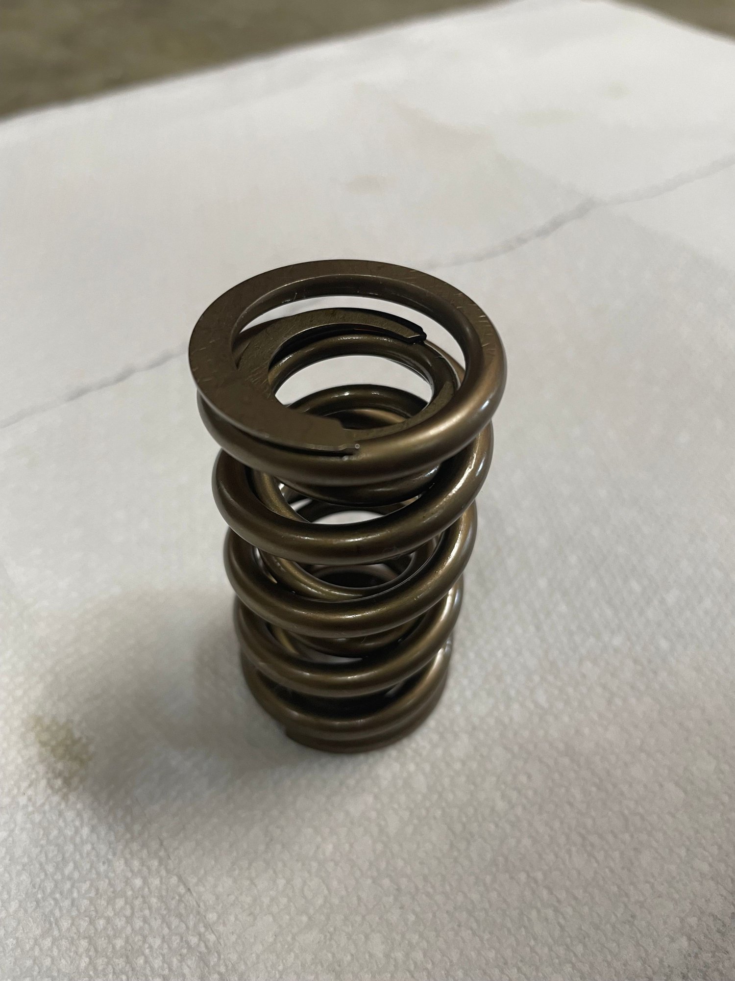

I am in the middle of swapping out my valve springs using a Tick kit that I bought with their stage 2 blower cam and have some questions.
https://www.tickperformance.com/tick...l-lsx-engines/
I am using the compressed air method to hold the valves in place and started with cylinder 1.
I noticed the ends of the springs are different. Which side is at the top with the retainer?

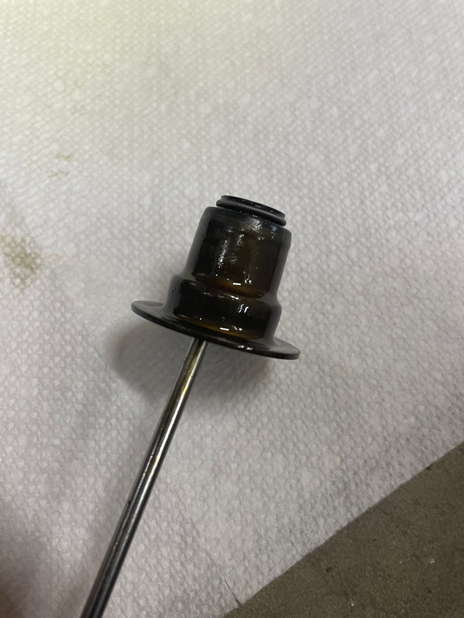

Also, I removed the single piece stock valve stem seals but the tick ones appear to be 2 pieces (flat black locator / stem seal - black or brown)

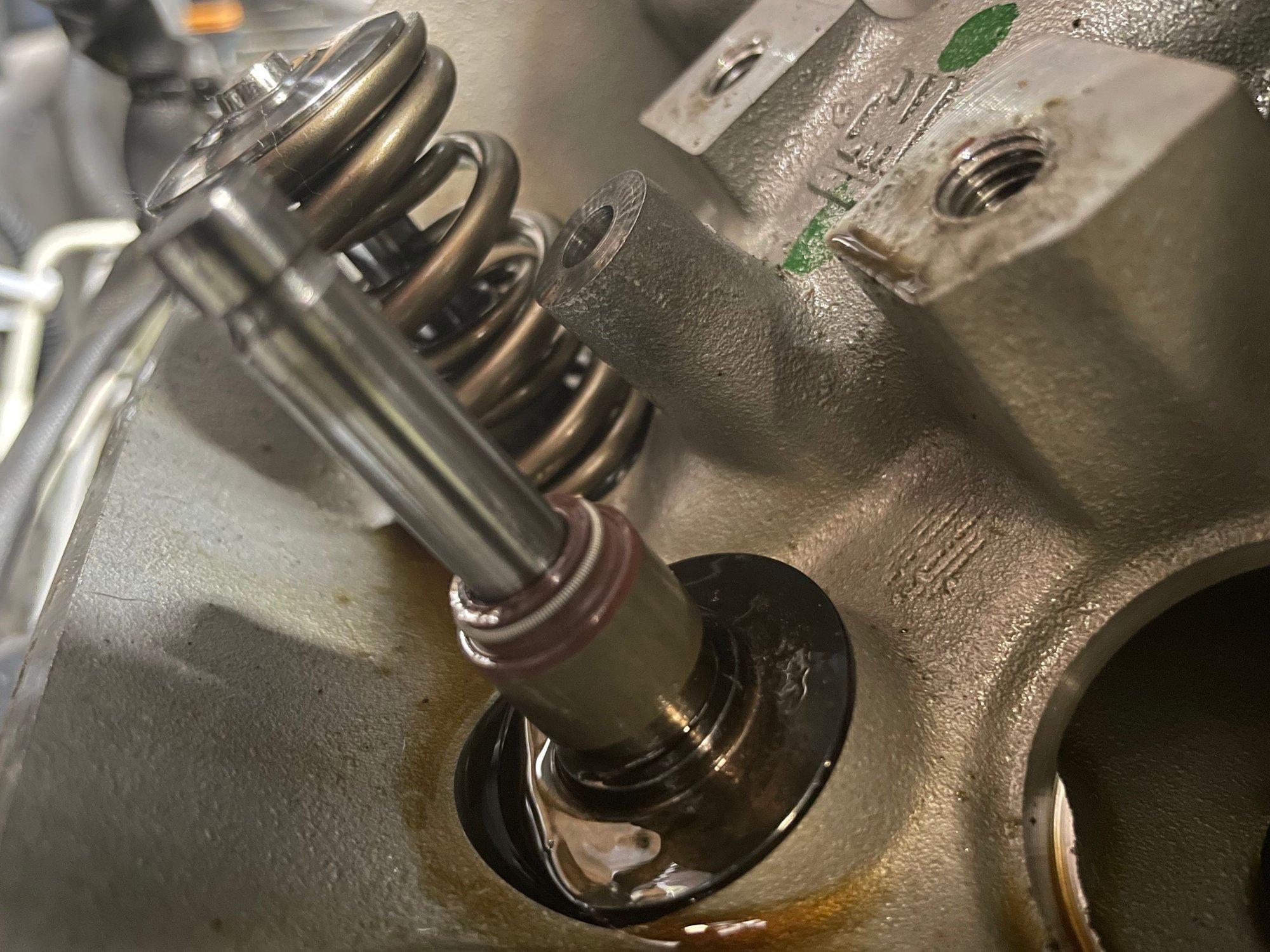

Using one of Tick's tools, I attempted to seat the valve stem seal against the flat black spring locator by tapping it in. There appears to be a gap and I'm afraid to hit it any harder without clarifying - does this need to sit flush or is a small gap ok?

I'm no expert, but when I did mine the seals did not go all the way down, I'd say 1/8" off. I put assembly lube on the stems, squared up the seals and seated them with the tool with a good push, no hammering. They only go down about a 1/4- 3/8". When you shove it, you feel it seat. The browns on the exhaust, black on the intake valves. I would suggest some assembly lube on the top and bottom of the springs. I juiced everything up even the retaining clips. As for top or bottom I don't think it matters, I put the flush side up. When it's compressed both inner and outer should be seated at both ends. Have fun.

When u install the spring it will take up that space from compressing it. when installing

Thanks! I've been searching LS1tech and it seems the gap is normal using the 2 piece stem and locator for the dual springs. From what I've read, BTR and others recommend the 2 piece setup and not the single "top hat" design when using dual springs. And it makes sense now that the orientation of the spring doesn't matter ultimately once it's compressed.
