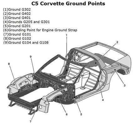

Woops regarding #2 I meant to say check and clean all the ground points under the hood. They're known to crud up with corrosion over the years and cause all kinds of issues. Reference

You can try replacing the key first since they're inexpensive. But only do it if the resistor looks worn/chewed up. If the key looks fine it's going to be the ignition switch because that's all there is at play. It could be dirty inside, it could be bent, broken, whatever. The audio problems sound like a poor ground path for something. Check and clean them all. It's good routine maintenance on C5s anyway.
