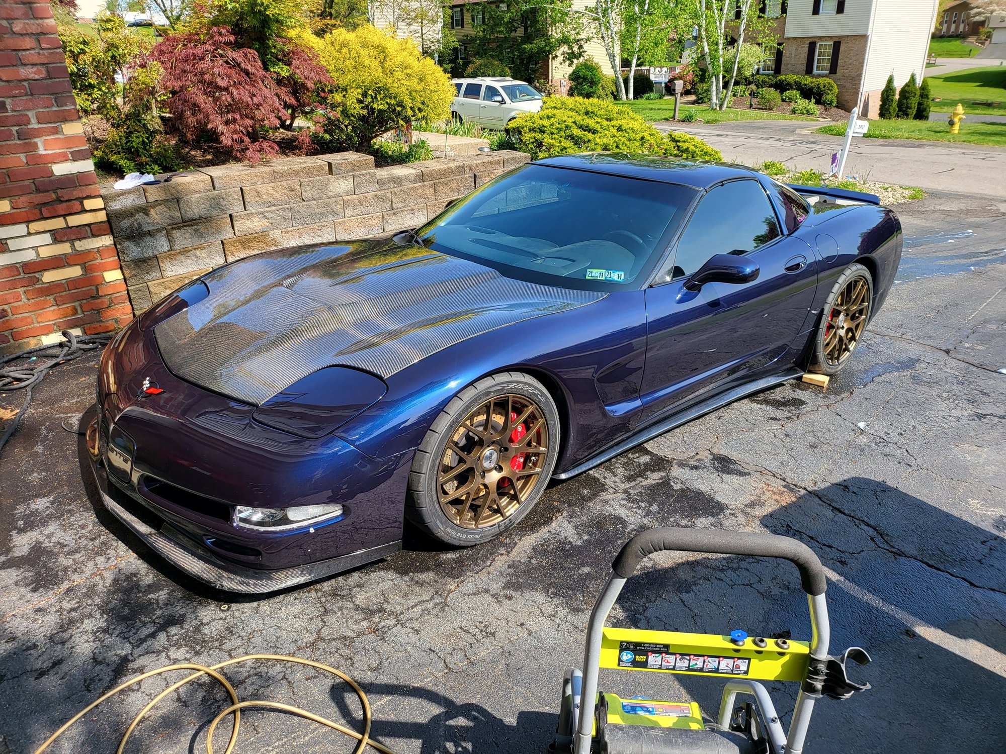

That's one heck of a good looking car! I hope you get it figured out quickly. Did you actually look underneath yet to see if the exhaust is all still hooked up right?
