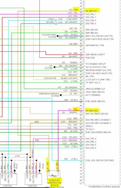

Does anyone have any experience installing a new IAT sensor connector? I bent one of the connections beyond repair on the connector and now the car is acting up because it cant get a proper reading on temps. I found the connector at autozone but have no experience rewiring any help would be appreciated.

There is no polarity requirements for the IAT sensor.
If you got a connector with wires simply cut the old connector off, solder and heat shrink the new wires to the harness wires.
Easy as cake.

Here ya go
To IAT Sensor Wiring
