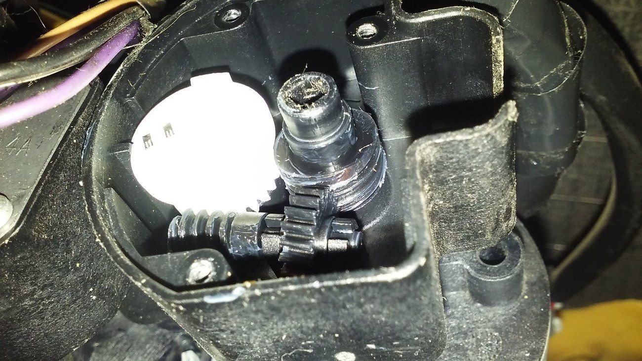

First try running the seat back and forth full range several times. The seat position sensor in the seat motor is subject to getting gummed up and the seat becomes unsure of its position. Some owners have taken the motor apart to clean the contact area with success.
Yes, it could also be a bad seat switch.
Here is what the seat position contacts look like inside the seat motor:
